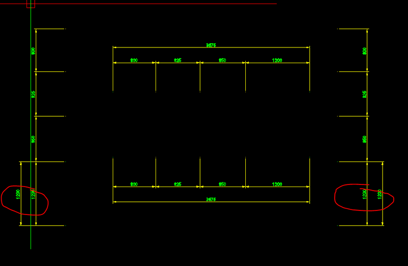

I just saw your drawing
The problem is that the code assumes that all the origin points of each dimension are aligned. The cases in which they are not, are not contemplated in the code.
That is, the code is intended for the 'dimaligned' command.
Edited by GLAVCVS
  • Thanks 1
Fixing this will make the code a bit more complicated.
Wait
  • Thanks 1
Wait
Expand
Drawing2.dwghere I all everything and it still gives me an error
Modified for 'dimaligned' and 'dimlinear'.
Give it a go.
I haven't tested it thoroughly.
Do it for me

  • Thanks 2

It is tested and it is excellent , thanks
