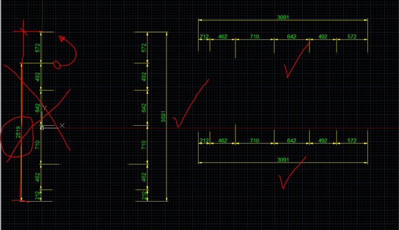

hello all :

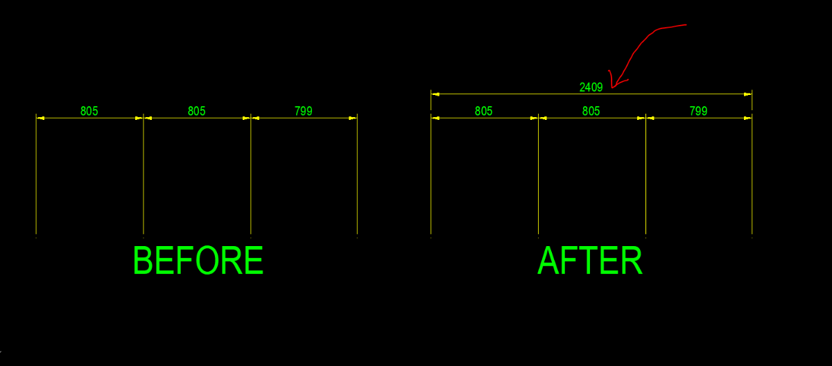

Does anyone know if this is possible?
if you have a series of previously created dimensions , make a selection in a window and create a total dimension above them
any comments are welcome

hanks, I had already seen it.
I found something that works for me and I'm trying to modify it
It serves to unite dimensions, that is, it creates one from two or more.

now modify it to prevent it from deleting the selected dimensions
I would just like the new dimension created to shift a little so that it doesn't overlap.
Something simpler
You may need to customize the offset
(defun c:agrupaDIMs (/ n conj ent lstent pt pt1 pt2 ptIni ptFin desplz desplzX desplzY punto)
  (setq n 0)
  (if (setq conj (ssget '((0 . "DIMEN*"))))
    (while (setq ent (ssname conj n))
      (setq pt1 (cdr (assoc 13 (setq lstent (entget ent))))
	    pt2 (cdr (assoc 14 lstent))
	    desplz (distance pt2 (cdr (assoc 10 lstent)))
	    desplzX (- (car (cdr (assoc 10 lstent))) (car pt2))
	    desplzY (- (cadr (cdr (assoc 10 lstent))) (cadr pt2))
      (if (< (car pt2) (car pt1))
	(setq pt pt1 pt1 pt2 pt2 pt)
	(if (= (car pt2) (car pt1))
      (if ptIni
	(if (< (car pt1) (car ptIni))
	  (setq ptIni pt1)
	(setq ptIni pt1)
      (if ptFin
	(if (> (car pt2) (car ptFin))
	  (setq ptFin pt2)
	(setq ptFin pt2)
      (setq n (+ n 1))
  (setq punto (polar ptIni (angle ptIni ptFin) (/ (distance ptIni ptFin) 2.0))
        punto (list (+ (* desplzX 2.5) (car punto)) (+ (* desplzY 2.5) (cadr punto)))
  (command "_dimaligned" ptIni ptFin punto)

It's precisely what I need,  I have only changed "_dimaligned" to "_dimlinear".

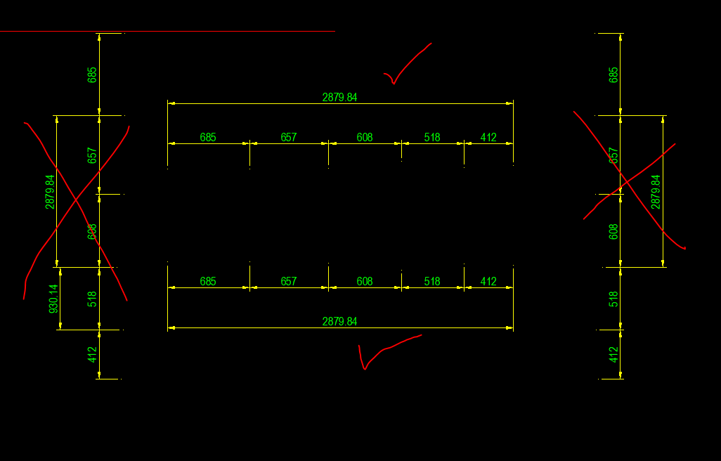

I have tried it in the following way , generate a group of dimensions I mirrored them and rotated them.
and this was the result...
Only on one occasion did he not do it as expected.
I don't know if the precision can be adjusted or something like that.
@leonucadomi
Copy the code again. Something has changed. Check if it works.
The accuracy should be adjustable with some system variable.
When I get home I'll take a look

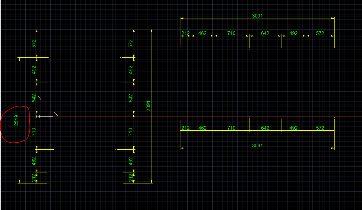

Expand
Adjust precision?
Do you mean add decimals?
  • Thanks 1
Expand
decimal precision no sorry,
the idea is that in any position in which the group of dimensions is located
up,down ,left or rigth dimensions are selected and a total dimension is added to those selected dimensions
I have improved the algorithm for calculating the displacement.
This displacement will always be done in the direction of the others.
I hope it helps you

Expand
It's excellent now yes , thank you very much

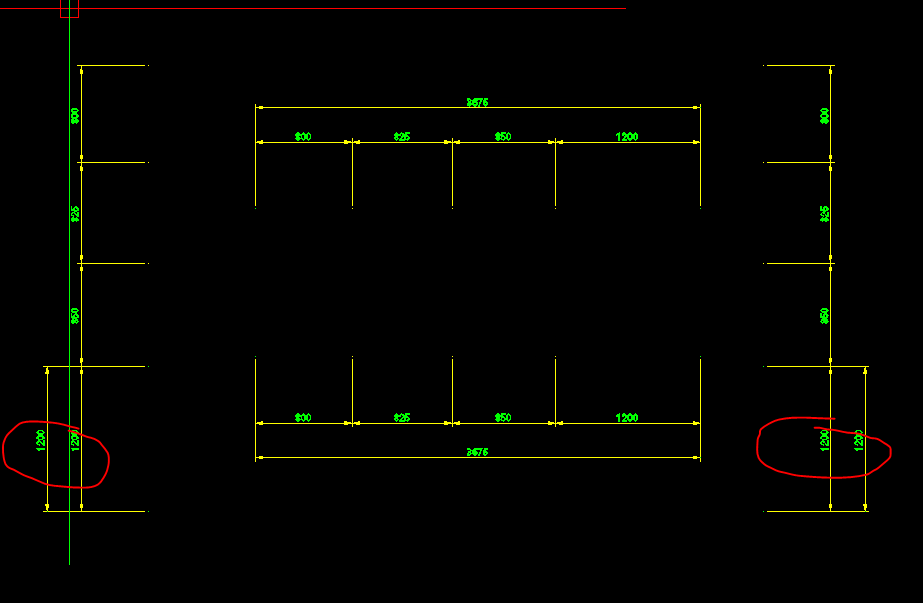

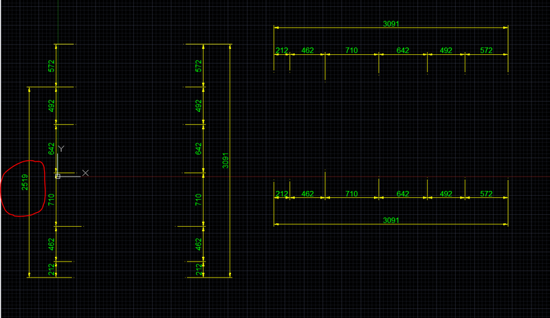

  On 2/7/2025 at 1:33 PM, leonucadomi said:
:( image.thumb.png.d4adcb6484eabba41798b821efc1638b.png
Expand
Edited by leonucadomi
WRONG
Very rare
Attach that drawing
  On 2/7/2025 at 2:27 PM, GLAVCVS said:
Very rare
Attach that drawing
Expand
sometimes it does and sometimes it doesn't ,  The routine that I put at the beginning of the topic does it well, I just want to move it so that it doesn't overlap
Drawing3.dwgFetching info...
