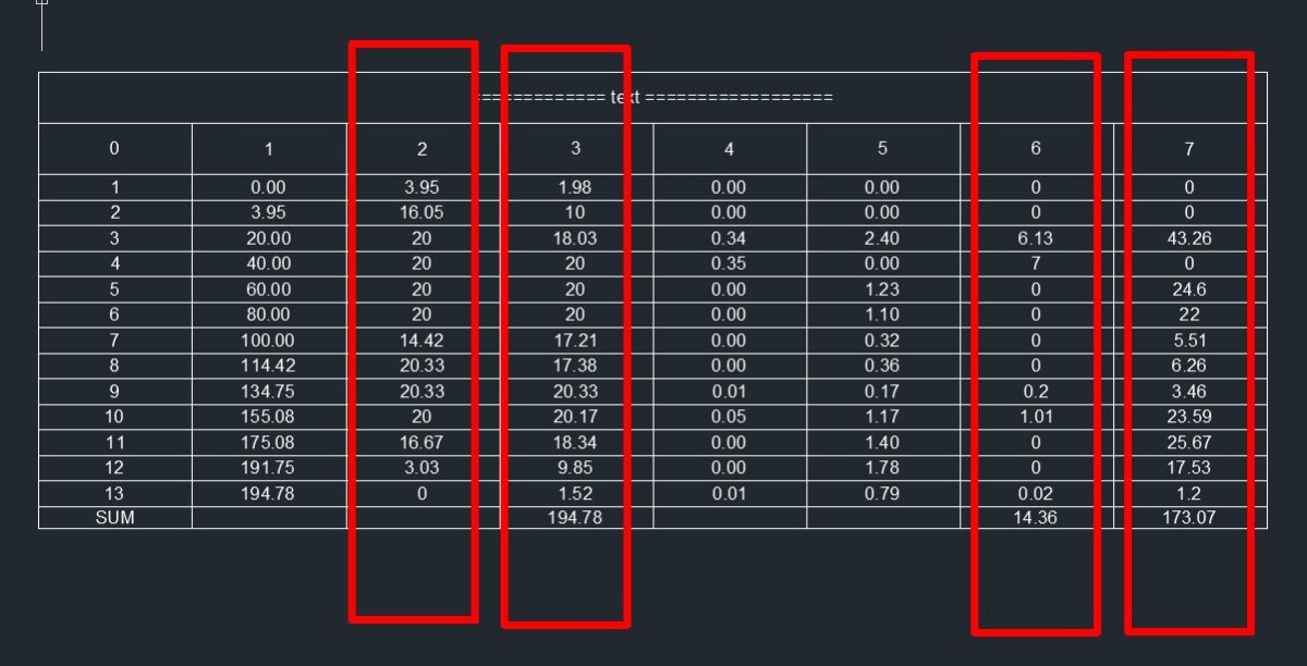

I update the code with the calculatios in column 3 but something is missing. look the dwg  to understand . Delete data from column 6  and more

any ideas?

I update the code. Dont delete data in rows now , but the calculation in column C is not in exactly in the correct possition. Look the dwg file.

Hi BIGAL I finished the code but I need to ask somethig simple
I want to add two decimals in the results and add
(rtos 2 2)
To the results  but is not working. Can you  help me to fix it. Is any other way to set 2 decimals?

A possible easy fix try this (setvar 'dimzin 2) at start of code.
: (setq num 20)
20
: (rtos num 2 2)
"20.00"
: (setq num 12.5)
12.5
: (rtos num 2 2)
"12.50"
: (setq num 12.345)
12.345
: (rtos num 2 2)
"12.35"
Some extra hints
;; Set the text height for the Title, Header and Data rows
 (vla-SetTextHeight custObj acDataRow txtht)
 (vla-SetTextHeight custObj acHeaderRow (* txtht 1.2))
 (vla-SetTextHeight custObj acTitleRow (* txtht 1.5))
; Set the alignment for the Data, Header, and Title rows
 (vla-SetAlignment custObj (+ acDataRow acHeaderRow acTitleRow) acMiddleCenter)
(vla-SetTextStyle custObj (+ acDataRow acHeaderRow acTitleRow) "Arial")
Edited by BIGAL
Hi BiGAL
(setvar 'dimzin 2)
fix the problem. Thanks
