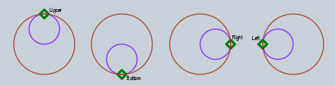

After entering the scaling factor, the code returns an error:
; error: invalid argument type: numberp: nil

How can this be fixed? Thank ...

Is it possible to add the ability to scale circles and text inside them together to this code?

The code added a selection of objects inside the circle for joint scaling, but there is an error...
; error: no function definition: CIRCLE->POLYGON
Please help me find the error. Thank...

Unfortunately, it gives an error again.
; error: invalid list of points
There is some other parentheses misplaced in the 'circle->polygon' function.

I thought that the error might be in the function, I checked the closing brackets, but found nothing.
Thanks a lot for your help, now the code scales circles with objects inside.
Here is the corrected code:
