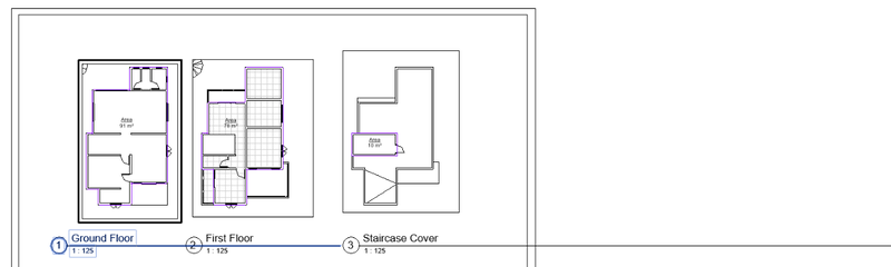

I have been able to find areas of different floors and put those area floors together in a sheet. It seemed quite similar to viewport in Autocad.  However I cannot align those views based on the geometry they contain which is possible in Autocad.  For example I have three different layout and I want to align them based on the lift/staircase or other fix X-Y point that remain unchanged in the different floors. Thanks in advance for your help and advice.

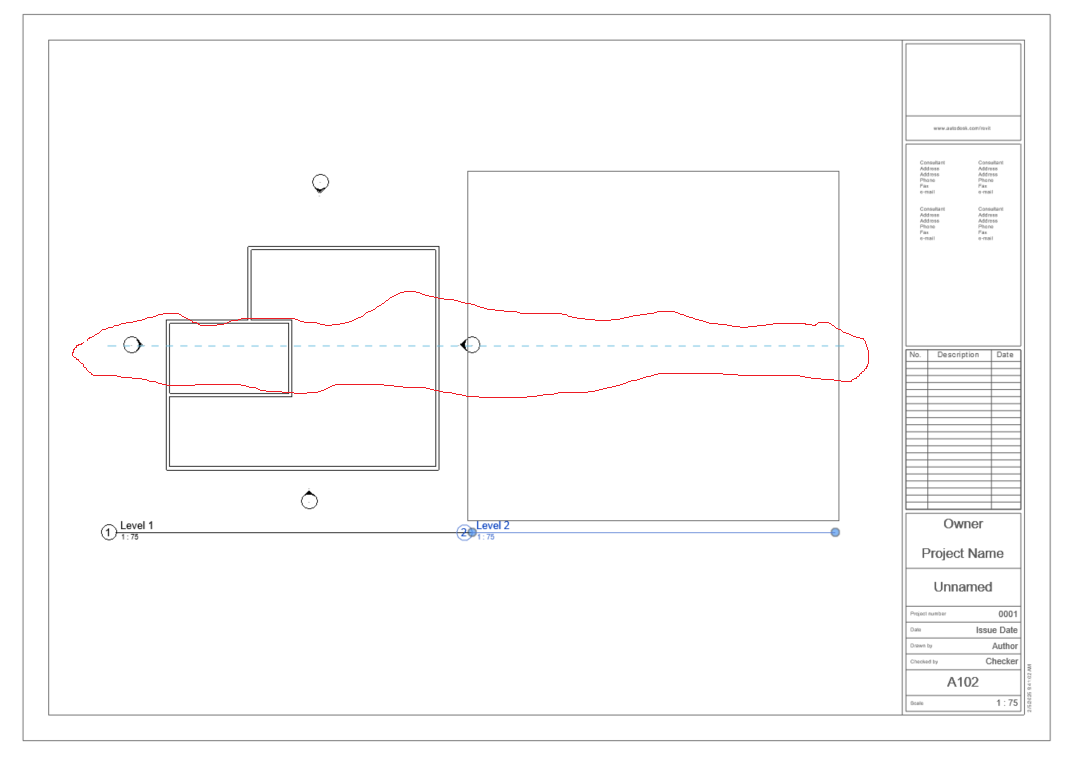

  On 2/4/2025 at 6:06 PM, nicolas said:
Hi.
It's fairly simple, as you can see in my example, while dragging the Level 2 Views into my sheet, an "ant line" (clouded in RED in the attached image) appears aligning your Level 2 view to the view beside it which is Level 1. You can also do this while aligning the View Title below the views.
For some reason, I cannot attach a GIF screen recording so I just zip it up and attached it here. Kindly download and unzip on your side to see a better example.
Hope this helps.

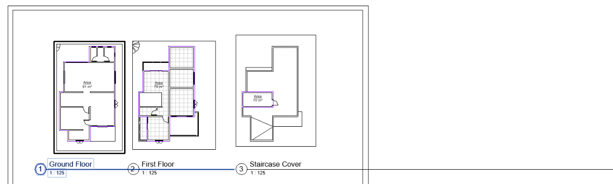

Ok I will check this right away.  I have found the ant line you spoke about when aligning the text below (also I was unable to edit the line so I have to discard the line part altogether).  I check and I revert back. Hope this works in Revit 2019.
Ok thank you Nod684. the ant line appeared only when the views are aligned.  Thanks.  I have been trying so many options on this.  If you can help me on the line next to the title. One solution was to remove it altogether i.e title without line

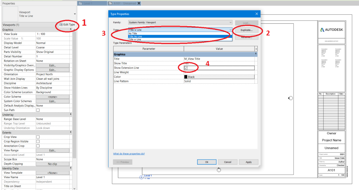

Click the view that you just placed.  Go to the Properties Panel click Edit Type (1). You can check the TYPE if you have other types such as mine in the example below. If you have you can skip steps 2 and 3 and just select the type that says Title No Line. if not you may want to go to DUPLICATE (2) and assign a Type Name (3) finally, uncheck the Show Extension Line (4)
