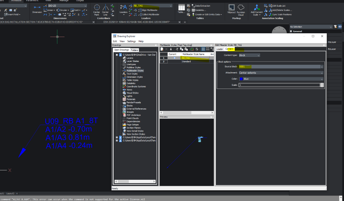

I have a drawing with many multileader object with attached block with attributes. The multileader, together with the values of the attributes I can automatically import by constructing "command" lines from excel.
(command "mleader"'(465032.48 6090342.36)'(465034.48 6090345.36)"U13_RB B1_8T" "B1/B2 -0.38m" "B1/B3 0.5m" "B1/B4 0.61m")
Next I would like to change the color of each attribute based on a condition - if number is greater, smaller, between ...
The challenge I have is that I can't reach the attributes directly from the multileader objects.
For the moment I have assembled following code from other scrips I have found on the Internet. It works fine only if I explode the multileader and the blocks are separate objects. I would like to keep the multileader complete and dynamic without exploding all of them.
I have attached one test drawing as well.

I don't think your mleader is correct need the use a block as a choice. Check manually.
Mleader O C Block bname........
Yes can read Excel from CAD so make the mleaders. Or a Macro in Excel will draw the mleader.

I have no real problem with creating the multileader. In fact this is a predefined multileader style with block with attributes as a content.
My main challenge is reaching those block attributes and "vla-put-truecolor" to it. Those blocks are nested inside the multileader and can't find a way to select and add to a set suitable for editing :(
FYI, I am using BricsCAD V20.

Thanks BIGAL,
The final sentence in that post made me think of another way of doing it :)
"I thought this was gonna be a simple fix to start with... Obviously blocks nested in mleaders isn't straight forward."
I made a dynamic block with a leader and attributes. This object is much easier to access and modify the properties of the attributes.
