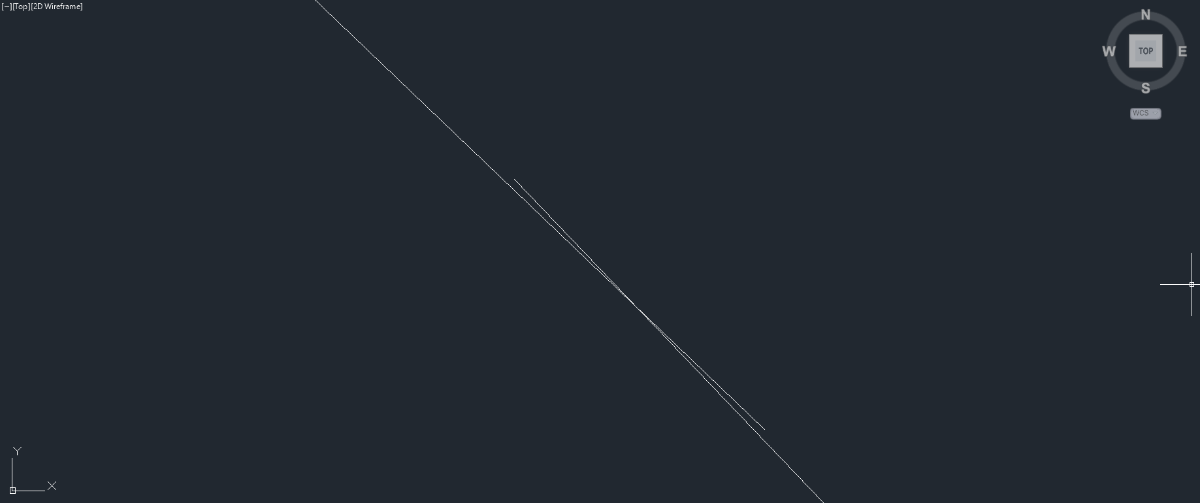

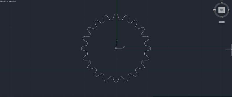

Hello, I am currently writing a Lisp routine to draw a spur gear with root fillets.
After using ARRAY, I realized there is this tiny imperfection between the teeth which makes it impossible to REGION.
I wonder if anyone has any solutions for this.
Here is the code for the fillet arcs. The full program is a research project so I am quite hesitant to share.
  (command "_ARC" "C" (list (- fillet_r) base_r) (list (- fillet_r) root_r) "a" 90)

Though in your case, you might just need a LISP, etc. to Trim and or Join the imperfections, maybe FILLET>R=0.
In reality, you have something slightly off with the math and could just be rounding errors and/or just a very slight imperfection somewhere.
You might want to post a .dwg and your math.

I realized that it was due to AutoCad being buggy again, probably due to the amount of curves on screen.
I managed to "solve" the problem by using BLEND, although maybe hiding the objects would work as well:
(setq fillet_angle (acos (- 1 (/ (* fillet_r fillet_r) (* 2 (- base_r fillet_r) base_r)))))
  (command "_ARC" "C" (list 0 0) (polar (list 0 0) (+ half_angle_base fillet_angle (/ pi 2)) root_r)
	   "A" (rtd (- fillet_half_angle_base fillet_angle))) ;polar angle in radian
  (setq unfilleted_base (entlast))
  (setq start_point (vlax-curve-getStartPoint unfilleted_base))
  (command "_BLEND" "CON" "S" start_point curve)
  (setq fillet (entlast))
  (command)
May this help someone in the future.
