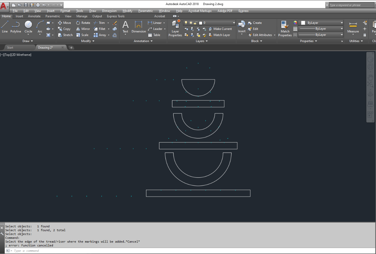

I have a lisp routine that works some of the time but the results are not the same every time, looking for some help.
You select an edge that you want divided up with marks at a certain interval and select which side of the edge to draw the marks on. sometimes it puts the marks on the correct side but other times it is a mirror opposite of the side selected.

You should attach an example drawing
Edited by GLAVCVS
  On 1/30/2025 at 6:19 PM, GLAVCVS said:
.The code seems to work fine
I have a drawing attached. And the odd thing is it works sometimes and sometimes not. It is also random on which machine it works on
Drawing 3.dwgFetching info...
If its pline/lines then i would have a good guess at Clockwise v's anti clockwise, it will make stuff go inside or out depending on direction, simple to check for. Also for plines need to use which segment selected not just pt1->pt2 etc.

Look at pt3 CADR. When you use Entsel  the CAR of the value returned is the entity name, the CADR is the point that was used to pick the entity.
I am really struggling to implement this into my code in the first post. Any pointers? I am also trying to relearn LISP from a long hiatus...

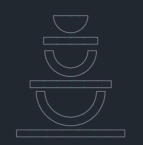

Further testing shows that if the X of the path is a negative number then the array path command gets all glitchy and does not provide the intended results from just command line entry. However, if I move all of my pieces to the positive side of X axis then it "mostly" works.
At this point I am looking for suggestions to move away from the array path command.
I need a 1" line(blue line in pic) aligned along a path(arc or line) at maximum 2' intervals. The line must be on the inside of the "piece"(white lines in pic). The pieces are closed polygons but not closed in regards to poly lines and they will not be poly lines.
