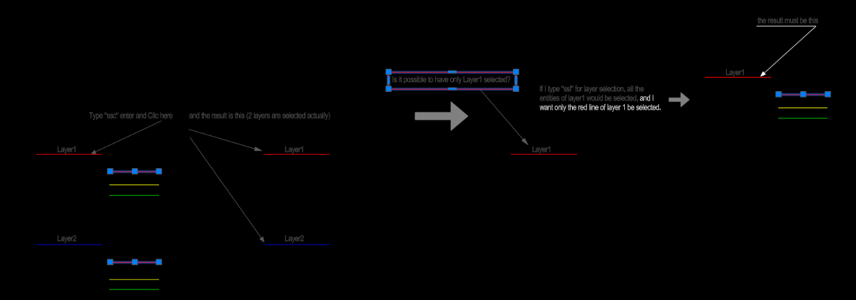

Hi,
"Special_selection" of Gilles is very useful. Typing "ssc" for color selecting. But when i select the color of layer, the others layers are selected.
That's not what i want to have.
Autocad file and "special_selection" lisp are attach for better explanation.
Thanks for your help.
Test-selection.dwg Special_selections.lsp

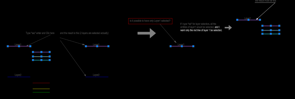

@thekiki I don't completely understand maybe, but it seems to work for me. "SSL" selects everything on "Layer1" regardless of color:
"SSC" selects everything explicitly set to a COLOR override (not "Bylayer"):
If you mean that you want to select everything that is "Red", whether it is actually Bylayer or not. Than you need something a little more complex; that iterates though the layers and finds the layer that matches the color. Then select all on that layer, EXCEPT anything explicitly color overridden to something other than "Red", then get everything else with the "Red" color override.

Pkenewell, thanks for your answer. What i want that when I select entity (by layer) by layer1, only entity by layer1 is selected,
whereas "ssl" select every thing on layer1.
The modification of "GLAVCVS" is perfect.
Thanks again for your reply.
