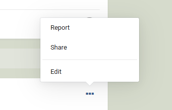

@kirby2 Select the 3 vertical dots on the upper right corner of your post, then select "Edit". To edit code afterward just double click on the code pane.
@Pkenewell
Thanks, mine only shows 'Report and Share' (maybe because my new user profile only has 7 messages - lost access to my original 'kirby' profile a year ago).
