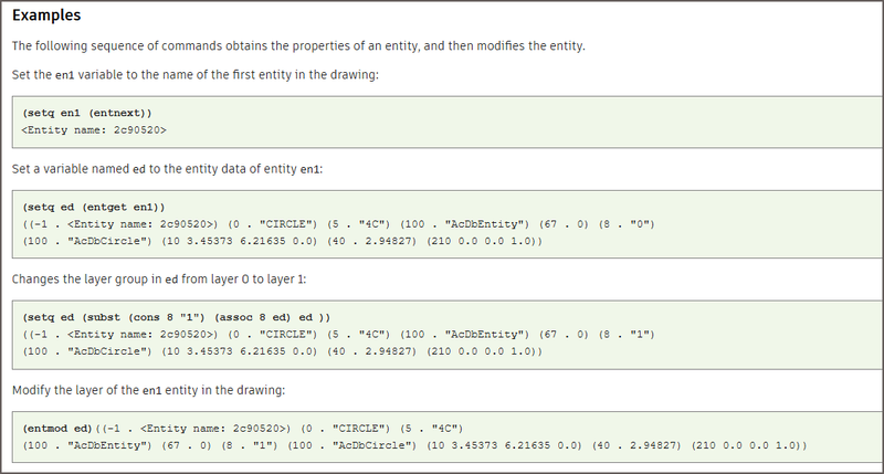

(entmod (subst (cons 1 newValue) (assoc 1 (entget att)) (entget att))) ; Change its value with "newValue" (???)
entmod confuses my head in ways I have never experienced before, the example I get from Autodesk help page is this:
I think I kind of understand it, at least the general concept, but that "cons" also gets me lost; I can barely explain what's happening here.

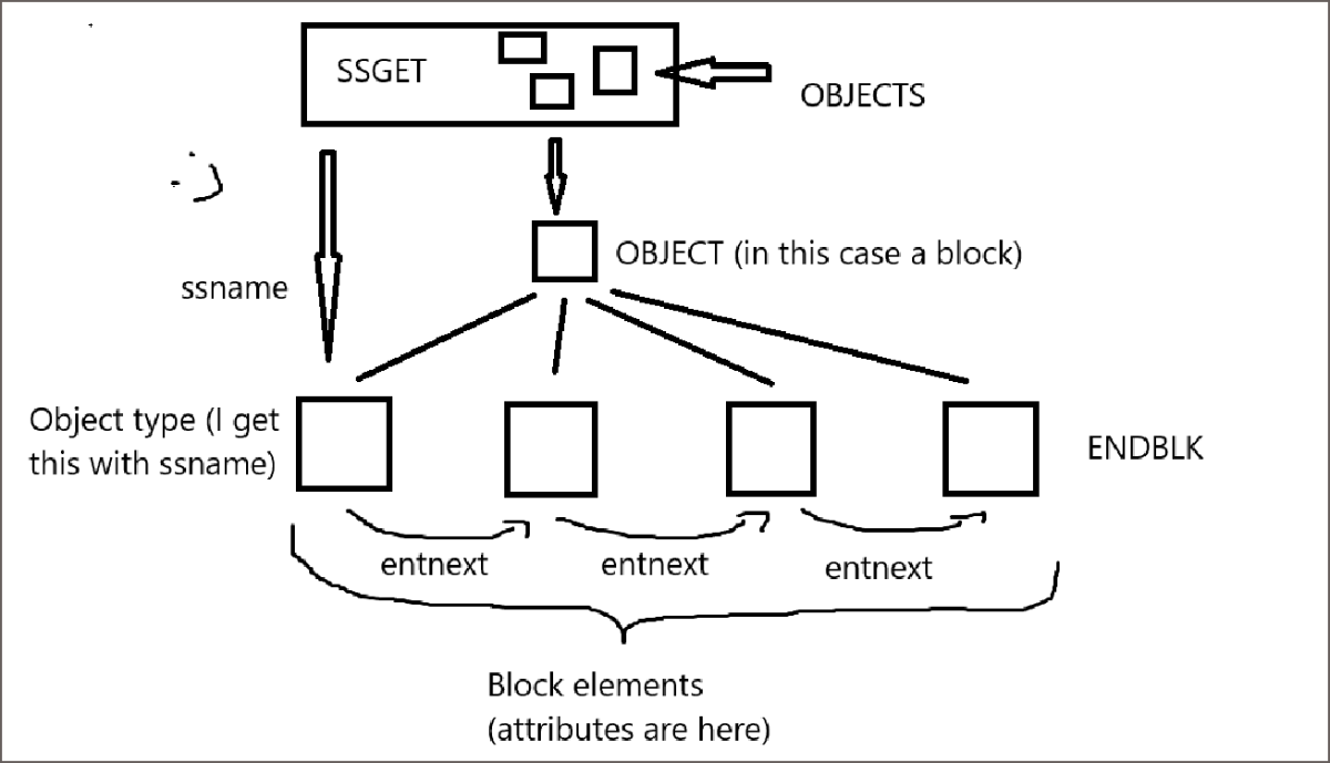

So, the way I see it;
AutoLISP gets a selection set (ssget), from that set you can get an object (ssname), and from that object you can get its entities (entget, actually I am now seeing that this part is not used at all in the code, thanks ChatGPT).
But, when you get an object, a block in this case (with ssname), you don't really get the whole block, but only what you call the "container entity", which is only the first entity, so with entnext you can cycle through all its entities, eventually reaching to its attributes (those where its property 0 is "ATTRIB") and finally to the last entity (with a property 0 of "ENDBLK").
I made an attempt to draw the way I think all of this works:
Is this any correct? I think I may be wrong in the fact that ssname gets directly the object type instead of a global intermediate thing that contains every element of the block.
Also thanks a lot for the answer! Even though I still have many questions, that clarifies some things.
'ssname' gets the object (entity name) whose index is given as an argument for a given selection set. One important detail I must stress is that 'ssget' only does sets of 'parent' graphical objects. That is, it will never include the objects included in any of those 'parent' objects.
