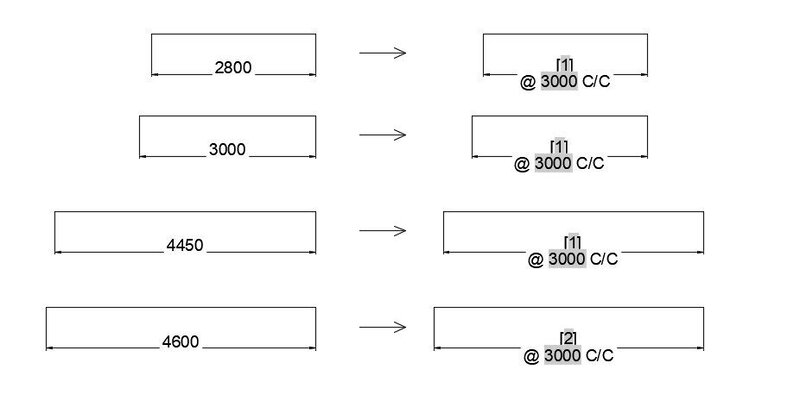

Afternoon All,
I'm looking for a lisp that would adapt an existing dimension and change this to show the original output + a further output that gave the original number divided by a given length of 3000. So, if we have a dimension of 1500 we have an output of "1500mm - 1 No 3000mm length", dimension of 6450 an output of "6450 - 3 No 3000mm length" etc.
The existing dimensions could be selected individually or a crossing selection.
Alternatively, rather than selecting dimensions, would it be possible to simply select a bunch of lines and automatically produce the same output dimensions
I did find a lisp posted by @irneb from back in 2011, but, it doesn't quite work for me. For instance when the selected dimension is broken up into multiples of 3000 leaving a remaining section that is less than half the 3000mm then it doesn't count the part left over. i.e 2800 gives 1 @ 3000, 3000 gives 1 @ 3000, 4450 gives 1 @ 3000 but 4600 gives 2 @ 3000 (See attached).
The original lisp was (thanks @irneb) :
Can you attached example drawing
Hi @hosneyalaa, thanks for the reply. Its basically as per the screenshot above, however, please see attached .dwg.
When recreating the example this morning, the results appear different from those produced previously - now I'm confused even more ðŸ¤ª
example.dwgFetching info...
The 4600 is wrong should be 2 not 3 is it not a length / 3000 then take the fix so / 4450 3000 = 1.483 so you have a fraction greater than 0.0 and the number is just add 1 to the fix of the length. This would be using a simple lisp adding field formulas may be difficult. I would also do a check equal with a factor of like 1e-8 as sometimes a 3000 can be 3000.00000001.

Ok got the math working, do you just need them labelled say Text or need a dim with 2x@3000 and so on.
(defun c:wow ( / end ent frac howmany len mp obj start)

Hi @BIGAL, thats certainly a massive step in the right direction. If you can get a label stating "x No @ 3000mm" that would be perfect. Thanks for your effort.
Code updated above. Could be a dim if you want, I will let you do that.
Edited by BIGAL
Thats great @BIGAL, exactly what i was after, thanks for your help on that ðŸ˜ƒ
Just be aware that I did not check direction of line so if drawn right to left the label will go under rather than on top. Could check for that though. Happy to help.
