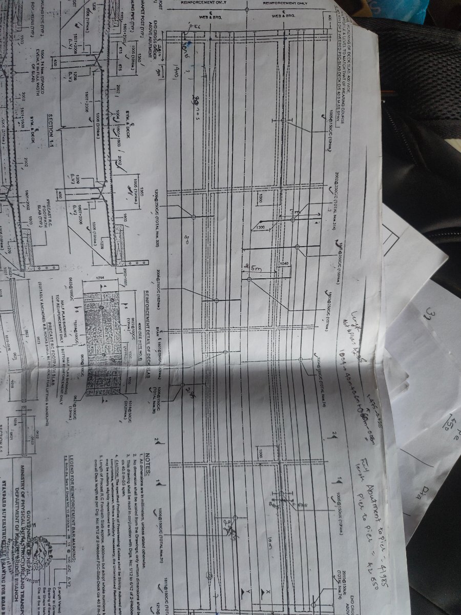

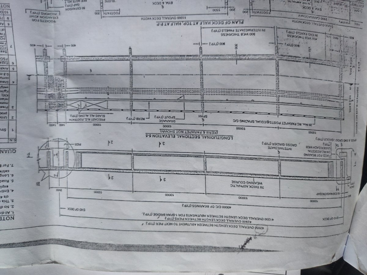

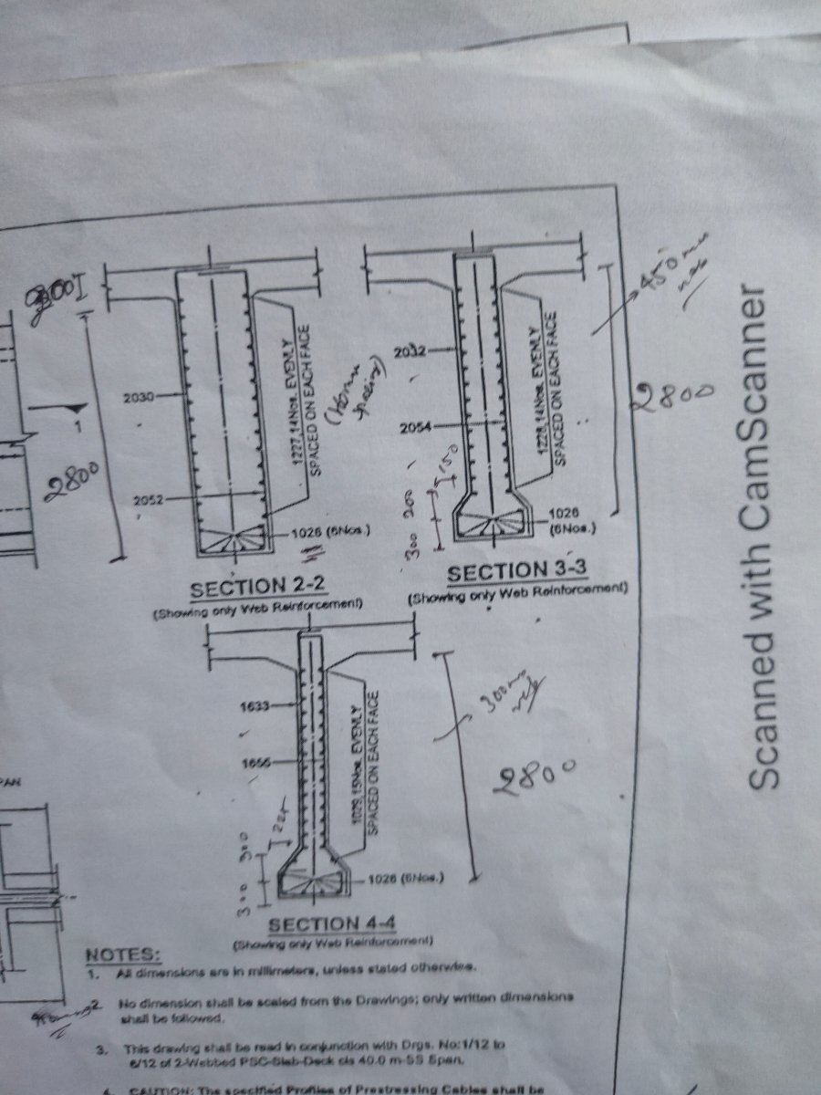

I am planning to learn revit for my current project i am working on. The superstructure has center to centee length of 40m. In which the cwntre to centre distance for I-Girder is 10m. The I girder section i have provided in attached file. However there is a varies portion in which Igirder width changes in one portion. How do i create it in civil 3d and export it to revit ro carryout rebar scheduling works.
