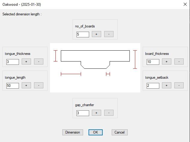

I currently have a lisp to draw even spaced T+G boards across a specified length (the measurement of a line is specified on screen)
I would like to be able to input the chamfer (default 3mm) and the gap between (default 3mm) as a separate variable, so i could have no space between them or i could have 2mm between but no chamfer (square edged)
I have added a drawing showing what the lisp does now and what I would like it to do.
Ideally it would also ask whether or not I needed tounges on the outside boards (explained in the drawing attached)
Current code is as follows:

any help much appreciated.

You posted this over at forums auto desk and som solutions were provider
Thanx for the intel Bigal, so chances are OP is a no-show. Did have some fun with this on my couch though (mainly because of how to make the image  (already thinking about how to automate this further) but for now I guess no use spending any more time on this because OP already has solution on other forum.
On the other hand , I needed the practice so maybe its nice to play with for somebody else...
oakwood.lspFetching info...
Edited by rlx
