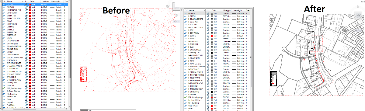

Hi @GLAVCVS
Thanks for lisp, few issues I've noticed while testing that LINETYPEs are not changing at all
Above Lisp routine unable to change the linetypes?
The code's tested in between two drawings, "A" and "B."
In drawing "A,"  (which i gave earlier), the custom linetypes are loaded. The Lisp successfully changes the color and lineweight, but not the linetype.
In drawing "B," (attached below) the custom linetypes are not loaded. The Lisp fails completely, throwing a "bad order function: COMMAND" error.
this is DWG A where line types loaded not not changed
this is DWG B attched below, Error Shows "Error: bad order function: COMMAND"

So far, I've reviewed and added only what is necessary to make your code work in the drawing/template you attached.
The part of your code that tries to load the linetypes is not good. When the linetypes are already loaded in the drawing, that code is not executed and goes unnoticed. But when the linetypes are not in the drawing, as in the last drawing you attached, when executed they generate an error.
So I had to replace that part of the code as well.
But then another problem appears: the linetype file you attached ('STD Linetypes.lin') does not contain the linetypes that appear in the 'standard' list.
I'm starting to get the feeling that I'm working for you 😅😅
I'm going to attach the result of my latest modifications.
I think that should be enough.

hello there,
Thanks for your suggestions. I've tried that, but it doesn't automatically change layer properties. also Layer Translator works, but manually mapping each file is too time-consuming and inefficient.
Dear Glavcvs,
Thank you so much for your help! I really appreciate it, and I promise I'm not trying to make you do all the work. Your support means a lot to me! 🙇‍♀️
Just to update you, after testing the new code, the linetypes still aren't changing to the correct standard. The 'STD Linetypes.lin' file is missing only the ditch linetype, but other line types are available but not changing. Rest is working absolutely fine and I'm really happy for it, also now I'm starting to think that loading a custom linetype with Lisp might not be possible.
"loading a custom linetype with Lisp might not be possible." look again at my post on page 1 it checks does linetype exist if not then load. Ok if must also do another defun using read-line and see if the linetype name is in the custom.lin, if not display a message. The wcmatch function checks the string for a matching text string. So if found set a variable to "Yes" if "No" then dont run the load part.

Dear all,
After many attempts (25+), and with the help of AI, I've finally arrived at a working LISP routine (below). I'm incredibly grateful for all your time and effort in helping me. To make this thread easier to navigate for others in the future, could you please remove the older attachments?
Thank you @GLAVCVS @BIGAL @ronjonp
LAYSET Tool Features:
✅ Auto-sets layer properties (color/linetype/weight)
✅ Smart LIN file loading if missing
✅ Wildcard layer matching
✅ You can modify as per your needs

10 hours ago, CADChaser said:
Estimados todos,
después de muchos intentos (más de 25) y con la ayuda de la IA, finalmente logré una rutina LISP funcional (a continuación). Estoy increíblemente agradecido por todo el tiempo y esfuerzo que dedicaron a ayudarme. Para que este hilo sea más fácil de navegar para otros en el futuro, ¿podrían eliminar los archivos adjuntos más antiguos?
Gracias@GLAVCVS @BIGAL @ronjonp
Características de la herramienta LAYSET:
✅Establece automáticamente las propiedades de capa (color/tipo de línea/grosor)
✅Carga inteligente de archivo LIN si falta
✅Coincidencia de capa con comodín
✅Puede modificarlo según sus necesidades
linload.thumb.png.0895977d848db77a6df040b7a3e73a7e.pngbfpic.thumb.png.564b1242712720076a3f1ce7eb7d4ca7.png
  • Thanks 1
