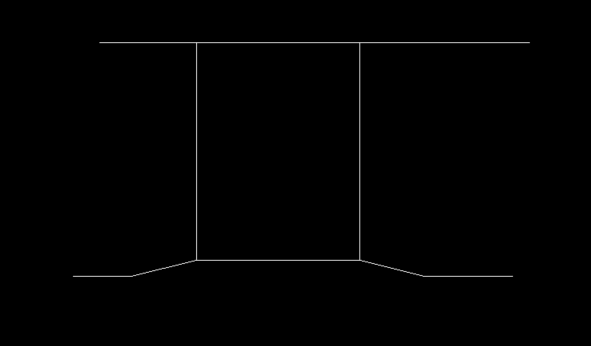

hey bigal, what takes the most time is tracing the streets, driveways, and sidewalks from a Google earth image. also ever time we cross a road with our cable we have to make a profile and add the utilities and dimensions

Only idea would be pick boundary line, pick sidewalk point, pick kerb point, and it draws multi offset lines based on the distance of the pick points.
I do have a draw driveway that cuts the line work for left and rightn sides, again will find. Have not used it for years and would probably need a edit to suit your task.

Here is driveway. It is setup for metric so if imperial may need to change some of the values in code.

Re draw roads only suggestion is to draw a pline centreline and then can do a multi offset in one go, eg 3,-3,3.45,-3.45,7.5,-7.5 this makes the left and right offsets. I have somewhere.
Maybe this
