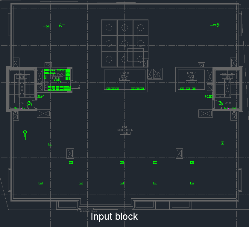

Hi Friends,
I have attached a sample document for reference. I need assistance in creating a function or tool that automatically generates lines based on the blocks I select.Thank you for your help.
Sample02.dwg
;;; https://forums.autodesk.com/t5/visual-lisp-autolisp-and-general/connect-selected-blocks-with-the-smallest-polyline-length/m-p/8419663#M377509 ;;;

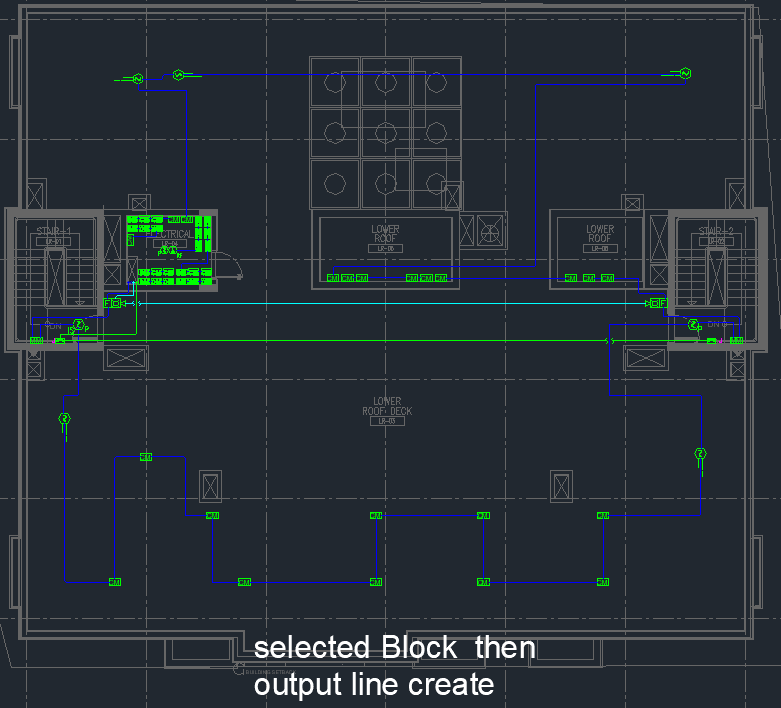

HI M.R
Thanks for the program. It's worked. Below, I have attached one more sample: the number of blocks is more than 600. If I select all the blocks, the line creates 18 or 17 blocks in a straight line. It's possible. The sample CAD file I have attached; please advise.
Sample-2.dwg
That second sample drawing has overlapping blocks.
It messes up the algorithm
It automatically generates lines based on the selected blocks. If possible, please help me it would be very helpful for me image.thumb.png.1092dfda97ccfc391100818ec2751135.pngimage.png.c5a3e5abdeaa9bdb383b032f197c22e0.png

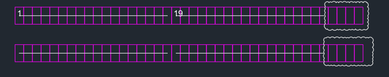

HI M.R
I’m not a Lisp programmer, but from my understanding, your midpoint function method uses a line to create and close the midpoint. The algorithm seems to work well, but in some random cases, there’s an issue. For the first row, first column, with 40 blocks, and the second row, second column, also with 40 blocks, the lines are created as follows:
From the first row to the 18th column block, and from the 1st row, 19th column, 36 blocks are created.
The same pattern applies for the second row and second column.
However, for rows 37 to 40, no creat line  .need want  like concept image.png.16f1ddfb3e71ba314fdff29d46b4dc56.png

I don't see a problem... You select 36 blocks instead of 40 and it draws lines like you explained as desired (first 18 from left to right and second 18 also from left to right - just in continuation from first)... Then if you select 40 it draws 2 lines - (first 20 from left to right and second 20 also from left to right - just in continuation from first)...
My friend's code is not the issue. The working area has more than 1000 blocks available for every project. My query is: when selecting (for example, 1000 blocks at once), can a line be drawn only for 18 blocks at a time, and skip drawing a line at the end of each block ,Is something like that possible?
I don't see why is for you the problem in selecting 36 blocks per row until all 1000 blocks are selected and then let routine finish the job... If I understood correctly you have 40 blocks per row and you want each row to be processed with 36 blocks... Is that correct?
Yes, you understood correctly
Here, try this revision...

@Tamim
Hi... I've improved my code to work well in any UCS aligned to grid dispositioned blocks and further more added versions for coulmns beside already posted versions for rows...
This is my FINAL version and I hope it will help you...
