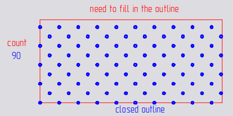

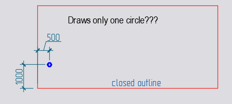

 It is necessary to place circles with a radius of 25.0 mm in a checkerboard pattern in a closed outline and paste the
number of circles in text in the drawing.  The code is not working properly. Draws only one circle???
How can this be fixed?

Your 'pointInPolygon' function is not working as expected.
I suggest you replace it with this one:

Circles are created with 'command': this means that they are object-snap sensitive.
Always turn off object-snap to avoid undesired results. Or modify your code to turn off object-snap at the beginning of code execution.
(defun comprobar_centralidad (pto lst_ptos_rto /
I am replacing these lines, but the code gives an error.

And now even one circle is not created...
I think you haven't implemented it right.

As I told you before, turn off object snapping - it looks like it's on with endpoint and midpoint
  • Thanks 1
Or write at the beginning of the code:
(setvar "osmode" 0)
  • Thanks 1

1 hour ago, GLAVCVS said:
Like that
@GLAVCVS Thanks a lot! Now the code works beautifully!

 (setq ent (car (entsel "\nChoose a closed linear polyline: ")))
 (if (null ent)
 (prompt "\nThe polyline is not selected. Completion.")
 ;; 1) Step Request
 (setq
 step (getreal "\nEnter the step between the centers (??): ")
 (if (or (null step) (<= step 0.0))
 (setq step 50.0)
 ;; the "backup" option
 ;; 2) Fixed radius
 (setq radius 25.0)
 ;; 3) List of vertices (minimum 3, otherwise not a polygon)
 (setq vlist (getPolyVertices ent))
 (if (< (length vlist) 3)
 (prompt
 "\nThe polyline has <3 vertices, and the contour is incorrect."
 ;; 4) Defining bounding box
 (setq minx (apply 'min (mapcar 'car vlist))
 maxx (apply 'max (mapcar 'car vlist))
 miny (apply 'min (mapcar 'cadr vlist))
 maxy (apply 'max (mapcar 'cadr vlist))
 (prompt (strcat
 "\nboundary (bounding box) polyline:\n"
 " X: "
 (rtos minx 2 2)
 (rtos maxx 2 2)
 "\n Y: "
 (rtos miny 2 2)
 (rtos maxy 2 2)
 ;; 5) Building a grid "in a staggered manner"
 (setq row 0
 y miny
 (setq osmant (getvar "osmode"))
 (setvar "osmode" 0)
 (while (<= y maxy)
 ;; For an odd row row, we shift X by step/2
 (if (oddp row)
 (setq x (+ minx (/ step 2.0)))
 (setq x minx)
 (while (<= x maxx)
 (setq pt (list x y))
 ;; If the center is inside the polyline, draw a circle.
 (if (comprobar_centralidad pt vlist)
 ;(pointInPolygon pt vlist)
 (command "_.CIRCLE" pt radius)
 (setq x (+ x step))
 (setq y (+ y step))
 (setq row (1+ row))
 (setvar "osmode" osmant)
 ;; ssget "_WP"
  (setq pl (car (entsel "\nSelect border polyline: ")))
  (if (null pl)
      (prompt "\nNo polyline selected. Cancel.")
      (setq points
        (mapcar 'cdr (vl-remove-if-not '(lambda (x) (= (car x) 10)) (entget pl)))
      (setq n (sslength (ssget "_WP" points)))
      (if (null n) (setq n 0))
      (setq sres (strcat (itoa n) " "))
      (prompt (strcat "\n" sres))
          (setq ip (getpoint "\nSpecify insertion point for the text: "))
      (if ip
                             (if (or (null textHeight) (<= textHeight 0.0))
            (setq textHeight 50.0)
          (command "_.TEXT" "_J" "_MC" ip textHeight "0" sres)
                   (prompt "\nDone.")
          (prompt "\nNo insertion point specified. Cancel.")
  (if (null ent)
      ;; 1) Step Request
      (setq
	(setq step 50.0)
      ;; 2) Fixed radius
      (setq radius 25.0)
	  (prompt
	  (prompt (strcat
		    "  X: "
		    (rtos minx 2 2)
		    (rtos maxx 2 2)
		    "\n  Y: "
		    (rtos miny 2 2)
		    (rtos maxy 2 2)
	  (setq	row 0
		y   miny
		circulos 0
	  (setvar "osmode" 0)
	  (while (<= y maxy)
	    (if	(oddp row)
	      (setq x minx)
	    (while (<= x maxx)
		  (setq circulos (+ circulos 1))
	      (setq x (+ x step))
	    (setq y (+ y step))
	    (setq row (1+ row))
	  (if (setq ptx (getpoint "\nPick insertion point for circle number text (right click or ENTER for skip)..."))
;;;	    (vla-AddText (vla-get-modelspace (vla-get-activedocument (vlax-get-acad-object))) (strcat "Number of circles drawn: " (itoa circulos)) (VLAX-3D-POINT ptx) (/ radius 2.0))
	    (creaMTEXT (strcat "Count:\\P" (itoa circulos)) (/ radius 2.0))

29 minutes ago, GLAVCVS said:
In the main function I have predefined the height of the MTEXT to half the radius of the circles. If you want to modify it you will have to go into the code and change it.
I have also written a separate command.
I hope it helps.
Thank, but unfortunately, it doesn't work.
The text with the number of circles in the contour is not inserted into the drawing.
; error: invalid argument type: lselsetp nil
I need a fixed text height if possible... Mtext is not needed...
This WP-count-txt code is suitable for me...
I just want to insert a text with the number of circles in the outline into the drawing.
But how do I add it correctly?
Edited by Nikon
I've edited the last code.
Now it will work
  • Thanks 1
There is also another detail:
in the command 'c:WP-count' you must change the selection mode from ' ssget "_wp" ' to ' ssget "_cp" ' so that it selects not only the objects that are fully included
  • Thanks 1
