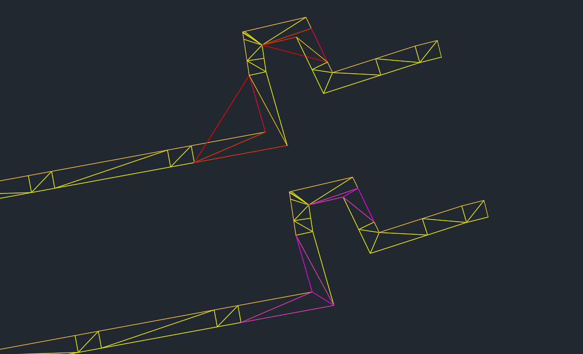

Hello everyone,
I'm currently working on creating a 3DFACE entities between two selected 3DPOLYLINE's. Also, I know it can be made with Civil 3D and there is a Triang V0.5.9.lsp file for that purpose. After a while, I'm continiue to work on this. I have a problem in making "proper" 3DFACE entities, sometime it's good, sometimes it's not. I would like someone to check those two uploaded files (.dwg and .lsp), try it and then help me with a solution to make a "proper" 3DFACE entities.
Inside the M3DFACE.lsp there is a functions:
     - SX:M3DFACEFPL (creating 3DFACE's from two selected LWPOLYLINE);
     - SX:M3DFACEF3DPL (creating 3DFACE's from selected 3DPOLYLINE);
     - SX:OFFSET3DPL (offset "base" 3DPOLYLINE 2.0 m on the desired side and make a new 3DPOLYLINE to make a breaklines for making 3DFACE's. Also, after the offset was done, it takes the Z value from "base" offseted 3DPOLYLINE, and that is OK for this solution);
     - SX:ERASENEW3DPL (deleting previous offseted new 3DPOLYLINE after the 3DFACE's were made);
     - SX:ROUND (not involved in application);
     - myerr (catching an error).
Inside "TEST_3DFACE.dwg" I left the 3DFACE entities after running the above functions, just so you can see what I get (bad 3DFACE's was colored into yellow).
Thanks in advance.
TEST_3DFACE.dwgFetching info... M3DFACE.lspFetching info...

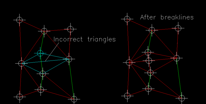

I think the answer you need is to work on a flat breakline working out new points on the 3d values of a 3dface.
As I have used civil software for most of my life why are you reinventing the wheel when out of box answers are there ?
This is because civil designer using Civil 3D trough all time on work. I'm traffic designer, and currently dealing with this changing and can't use the licence for Civil. This is the short explanation, don't want to go in details.
Can you @BIGAL give me more information about this?
Breaklines as a rule go from a point to a point. They are not random lines across a TIN. If your 3dplines pts are not part of the TIN then they need to be.
 A Breakline for others is an edge object. But the triangles have not connected correctly. So extra triangles are made. Green line is say "top of bank" ie a breakline.
Sorry you will have to work out the new triangles.
I believe both selected 3D polylines should have approximately the same number of vertices to generate better 3D faces.
If your talking about the yellow 3d faces then something has gone horribly wrong during TIN creation they should not look like that. The triangles should have a side with shortest distance. ie between the 2 lines, I would remake the TIN again some thing is wrong about the TIN.
If the number of vertices is equal, 3DFACES are good. But, it is not common, especially when you "offseting base" 3DPOLYLINE, LWPOLYLINE, etc.
Yes, the yellow 3DFACES, and it's not good.
This sounds okay and I think it should be checked before I create 3DFACES in a "while loop", but I need some advice or guidance on what to check (I'm currently stuck here).

  On 1/21/2025 at 7:21 AM, Saxlle said:
Sorry for not answering earlier.
I think I misunderstood your drawing at first.
I think you should introduce some proximity filter in the code to decide which polyline the first 2 points of the triangle are taken from.
This would prevent the formation of implausible or transgressive triangles.
Edited by GLAVCVS
I've thought better of it.
I think the best way to filter the choice of triangles is by the angle relationship between their vertices. This way the problem of the difference in the number of vertices of each 3D polyline will be greatly minimized.
That's why I've dared to modify your 'SX:M3DFACEF3DPL' function by adding a couple of new functions that serve to select the vertices of each '3DFACE'
I haven't tested it in depth. So it's possible that some unforeseen situation may arise.
If so, let me know and I'll help you find a solution.

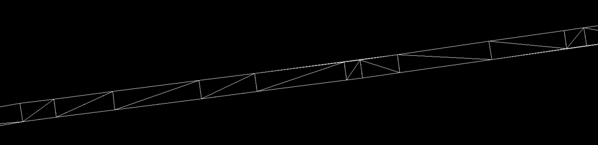

@GLAVCVS having spent some 40+ years playing with TIN's there is just something wrong with the creation of the original TIN model, using commercial surface TIN creation would not make the TIN between 2 3dpolys in the way that they have been made. If a free version of make a TIN is required then look at TriangV0.6.7.lsp by YMG. Before computers were fast have watched a TIN being made and it uses a spiraling out from middle when making triangles.
To quote TriangV0.6.7.lsp ";; C:TIN, Generates Delaunay Triangulation and Voronoi Diagram."
This is the two 3dpolylines TIN Made with TriangV0.6.7 you can see correct pattern.

@GLAVCVS
Thank you to your time and effort 👍. I'v tested your updates, and it's work better than my original making of 3DFACES. From BIGAL previuoses post, i'v been thinking about "shortest distance" or "angles between vertices", but didn't know what to includ in comparision, until you did it. After testing, it happen next (picture 1):
 - in this situation it takes wrong element from the "list of points" (from code it is in ptlistOne and ptlistSecond) to make a 3DFACE. In my opinion, inside the sub-function "decideTRI ( / a b)" need to include a comparing between some other points in that case that we have sub-function "decideTRI ( / a b c (maybe d) (maybe e))" with options (c, d, e, ...) and to find "min" angle to make 3DFACE from correct list of points (maybe to put it in "cond" statement insted of "if" statement).. From picture 1, the yellow color of 3DFACES are good, the red color of 3DFACES are made after run the "SX:M3DFACEF3DPL" and the magenta color of 3DFACES is desired output (changed it manually just to show).
I hope I explained well.
Once again, thank you.
I think the solution to this problem is to determine what is inside and what is outside, in the direction of travel of each list of points.
Once this criterion is established, it will be possible to filter out the offending triangles from 'decideTRI'.
If you haven't solved the problem in any way, I'll try to do it myself this afternoon.
