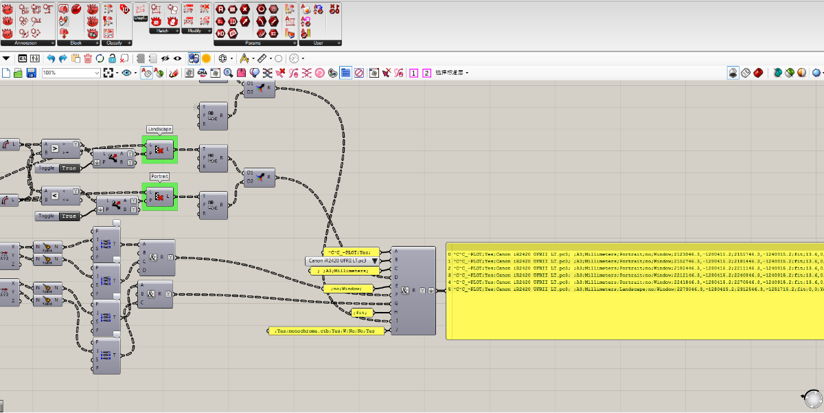

I created a link between Rhino and AutoCAD, a very good thing that can be used in many cases, finally this multiplemacrocommand is automatically created in a text in AutoCAD, and it would be very simple to just copy this text and enter it in the command line to print everything.

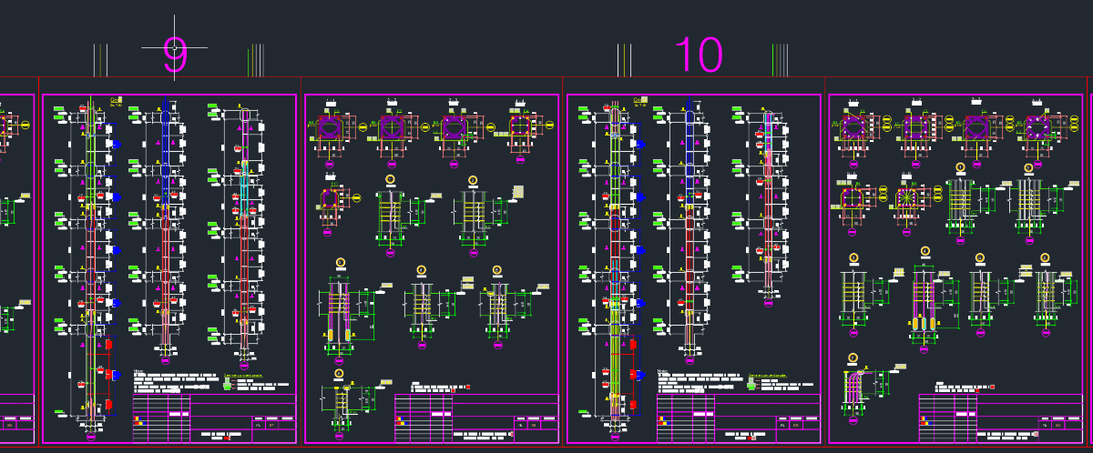

I tried the layout method before, I have been working for many years, the method without layouts proved to be the most effective and the document is much faster, although the computer I work on is quite powerful
here an example of what I am trying to print , here is an example of column reinforcement
and sometimes it could be like 40 types of columns , and document gets very heavy ...

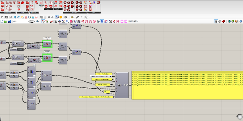

this rhino plugin for grasshopper help me also with other trics ,
and that why , i want to use it also for printing , the list of point is the left down point of page  and second pair of point is the upper right
the plugin give all the point coordinates and orientation of the page also automatically put the numbers for all pages , automatically know recognize where is the beging and where is the finish
I have all the information I just need to attach it to a comand , I gues to a lisp one
