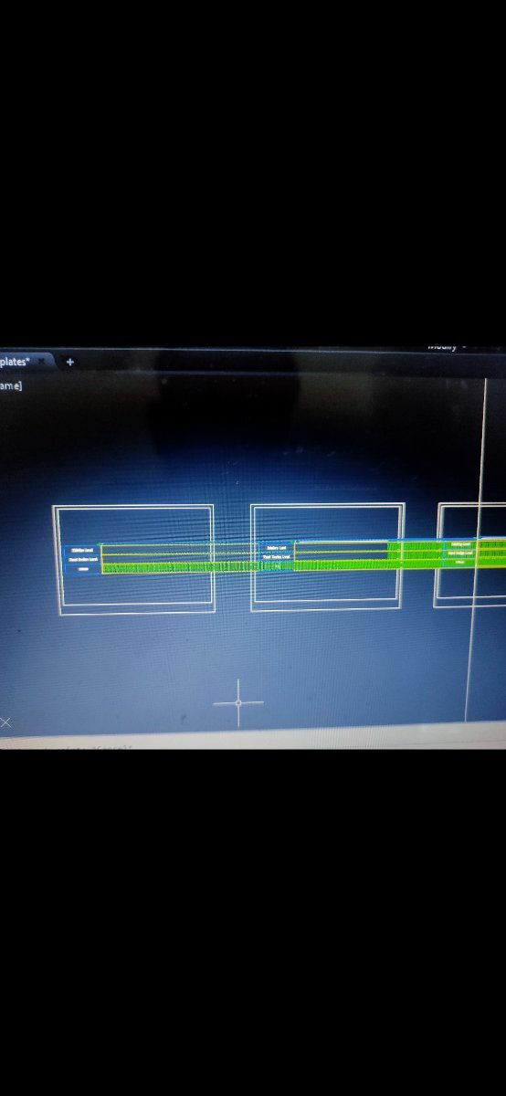

Currently i am working with my cross section to fit it in layout. The length of cross section width is 800m, i had drawn it in scale of 1:200. Now i have to fit it in my layout. But i am not able to do it. Do anyone have any idea what i need to do to print it in A3 paper.
Also is there any way to break a cross section in different parts and place it in layout? The construction line shows my drawing length
Please kindly help
If the cross section ends up more than 400 wide then you will have to change scale. Say 1:500. But you may not change vertical scale, you can make the cross section a block change the Y scale explode it and reset the text to stop the vertical exaggeration.
If you want the cross section across multi sheets then use layouts with the cross section in model, and use viewports.

Thank you. I am using civil 3d
