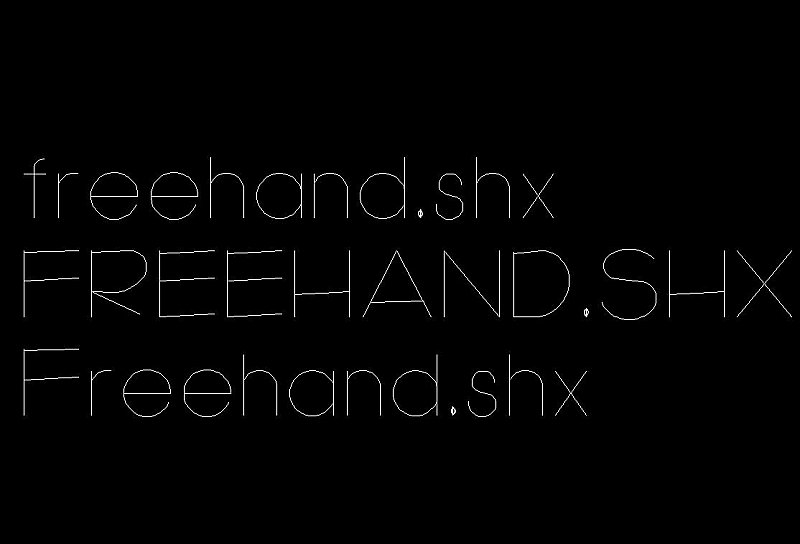

ReMark Posted April 16, 2009 Posted April 16, 2009 I have a freehand-type font but it looks more like this. Quote

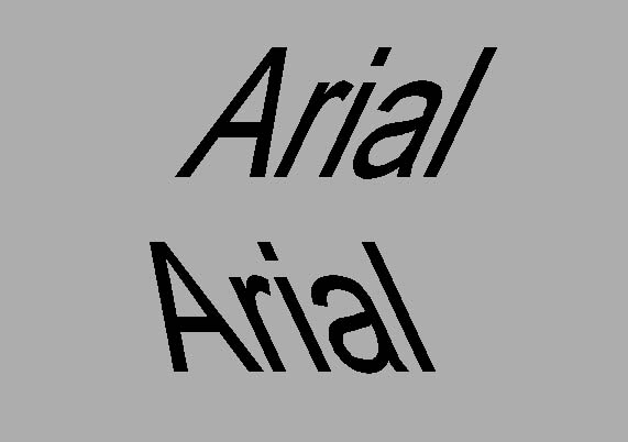

eldon Posted April 19, 2009 Posted April 19, 2009 If you are referring to tilting of True Type Fonts, they can be tilted by entering an obliquing angle. But they can't be tilted at random angles Quote
