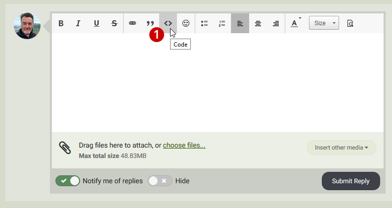

@Discus84 Use <> when posting code
code-post-1.png.d4f30f78f1e2328d85b9144975da9183.png.9e11748480c91a4f3c788a36387890e3.png
Edited by mhupp
