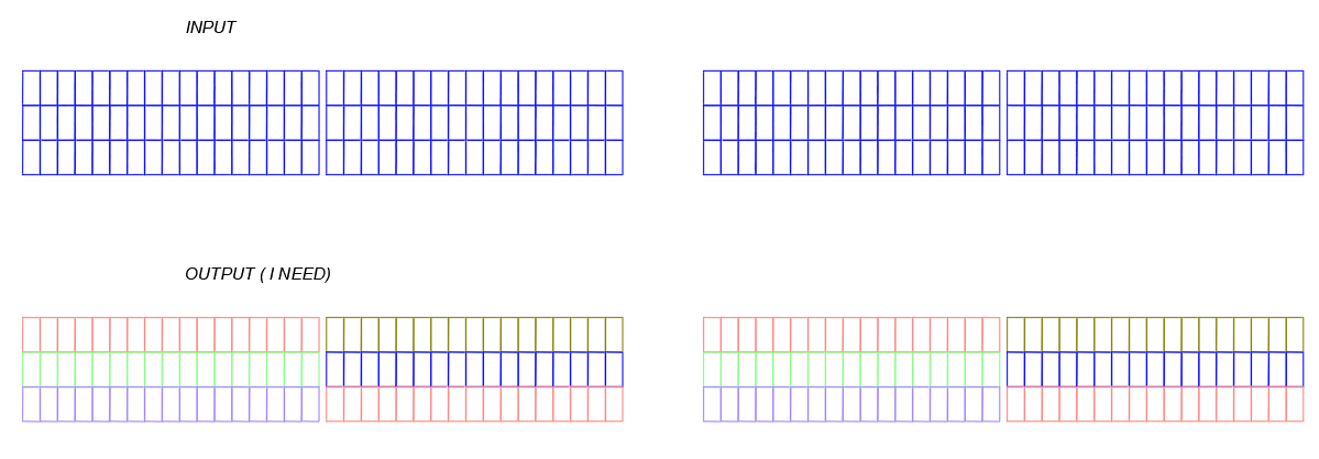

I would like to request your assistance in creating an AutoLISP script for AutoCAD that automates the color change of blocks based on user input. The task involves selecting blocks with the same name, after which the user will provide a number (e.g., 17, 16, or 15). This number will represent the panel group size, and the color of the blocks should be automatically adjusted accordingly, with sequential color assignments (e.g., red for the first group, yellow for the next, etc.).
It is alwas best with requests like this to post a sample dwg, should be doable.
I started to do something then realised doing it wrong, just ask how many columns,  how many rows, then draw the panels with different colors. No indication of colors required so just goes up 1 each time ran, if more than 1 Block this can be added as a choice and the panel size will be in accordance with that block.
So this is very much version one.

For this to work edited Block 560-jkm to be vertical and lower left is at 0,0.
You need to save multi getvals in a support path as its autoloaded. Else put full path in (load "C:\\mylips\\Multi getvals.lsp")

Thank you for the program. However, the block is placed horizontally, but I need it to be placed vertically.pls advice
After loading the "Multi GETVALS.lsp" application using APPLOAD, the comment name "Multi GETVALS" does not appear in the list. Please help resolve this issue

Save Multi getvals.lsp to a support directory or change the (load "c:\\yourdirectoryname\\muiti getvals.sp") as I autoload it, no need to use Appload.
I did change your block I used bedit and rotated it 90 degrees and moved lower left to 0,0 then code should work.
Do you have different size panels these can be added. So can do horizontal or vertical.

Thanks for the advice. The panel size hasn’t changed, but we’ll decide between horizontal or vertical based on the available area. We prefer vertical, but if there’s no space, we’ll go with horizontal. waiting for your valuable feedback
Thats ok as I said first go at solution, you can ask hor or ver then the two size values will be swapped and the code should still work, with the block rotated also on insertion.

Working perfectly. Many Thanks
