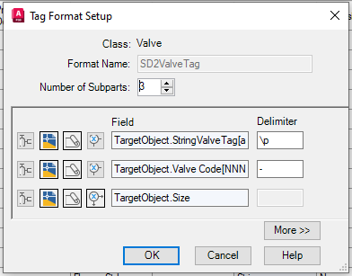

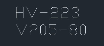

Hi all, I have a multiple line block to label objects the variable is something like this "HV-001\\pV500-100" or sometimes "HV-001\pV500-100" (single \) I was hoping the \p would populate the block attribute with the V500-100 on the second line but it doesn't 😞 what would the correct function be to replace the \p or \\p with either a space or just remove it with no space at all.

2) The "\P" is the paragraph return code in the Multiline text. You can't use "\P" in the internal AutoCAD editor as it will add the extra escape character, taking it literally.
In an AutoLISP routine, when you supply a string you have to add the escape character - the extra backslash "\\P" - to prevent the AutoLISP interpreter from thinking it is a unicode character (like "\n").

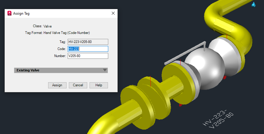

Hi Guys, Thanks for the prompt reply, so here is a bit more information:
I am trying to tag a Plant 3D Valve in the model, so that the numbers are visible in Navisworks (a client request)
I have tried to write a lisp code and was hoping not to have to expose my limited knowledge of Autolisp 😄 Nevertheless, attached is the plant 3d Drawing with the tagged Valve, my block with multiline attribute and my crude Autolisp code, that I have cut and pasted from a number of other posts I have found.

@Rovinator It looks like your TAG is not properly formatted for my new code. Let me know if this is what it is the tag is supposed to be because I don't know Plant 3D very well. I re-assigned the tag and everything works for me. NOTE- my program adds the return code (\P) into the block attribute.

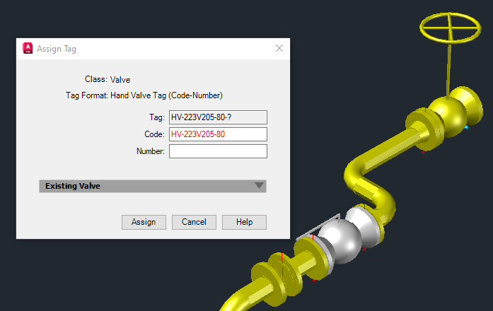

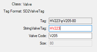

@pkenewell The tag should be as you have it except for the dash after the 223 like below:
Thanks again for all your help!!! Have a great weekend!!
@Rovinator Ok - Is the entire sequence added to the "Code" part of the tag? Because when I re-enter the tag, it adds an extra dash in automatically. Please explain the tag format and how the tag is entered, because even if I add the tag all to the "Code" portion, it adds a "-?" on the end (see screenshot). Also - now there is no delimiter to separate the tag, except for maybe the "V"? Is it always the same?
