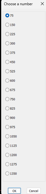

Does it have to use a Block ? For me just enter the sizes and pick pt1. Then just draw the objects. If the pdf is just showing a rectang as the block rather than a true object then why cant you put the X scale for the block. Re starting at 75 up to 1400 can use something like this.
Need the vertical size of the rectang. What is the gap to the block.
So if you have blocks that are not a rectang what is there names like 275rec etc ?
The best thing here is post a real dwg I am sure can be automated.
