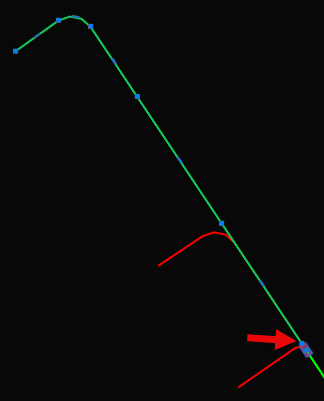

you didn't get my point ... i have thousands of these in drawing
i can't determine the polylines at the right direction of the block .. this is the part i need help with
i need code to select the polylines at ( right direction ) of the block

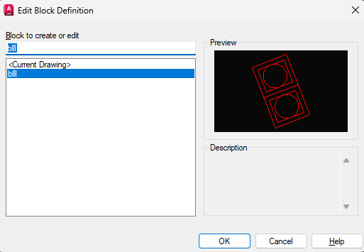

Explain how 'right'  is calculated when in this scenario the two blocks have the same rotation?
Having the block definition at a random rotation does not help either...

Depending on the side of polylines end points
Sorry I don't follow. The geometry is drawn with all start points originating from the block so what is "right"? To me the bottom example is visually left. The block rotation is the same even in a mirrored situation. Look at the visual below.
I got your point .. can you change the color of any direction right or left .. so the right differ than the left
all polylines connected to block base point

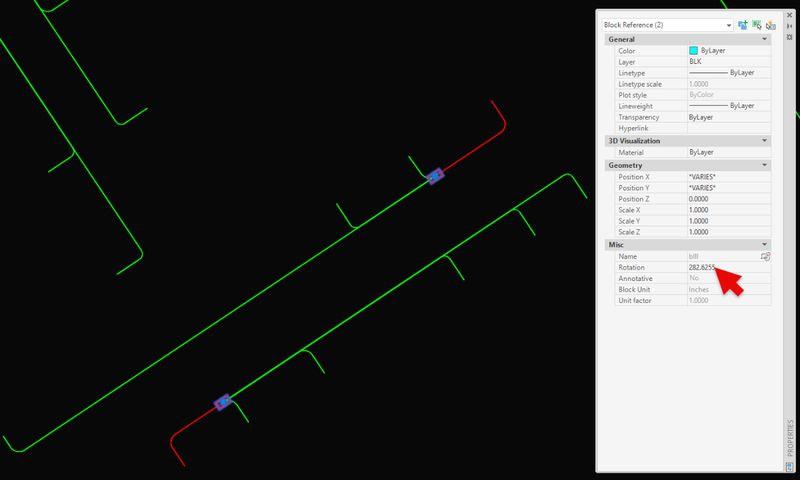

I can't change your drawing because I still don't know what the 'right' side is. 😂 Could the 'right' side be the one that has the shorter or longer amount of polylines and your example is wrong?
However this is drafted ( by code ? ) the blocks need to have unique rotations and a set of rules to discern the correct side.
when you look at the block .. some polyline at one side of the block and other polylines at the other side of the block .
Edited by Engineer_Yasser
🤣 Well that's pretty easy to do. 'Right' is not orientation but one or the other. The code below will select the side with the smallest cumulative length ( because I'm a dork ).

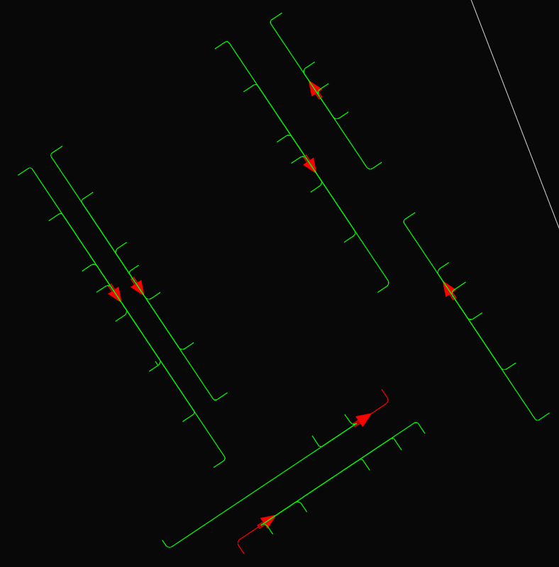

From the attached picture, I can't change the color of polylines into the yellow from the blue "circle" (it changed the color from the "wrong" side).

After the test, i get this (see attached picture). The "white" color is sections which I made for testing, the "magenta" color present the polylines which are not changed, and the "red" color present the "one" polyline which are not starting from the "base point" of the "blll" block and the color was not changed into the "yellow". The "cyan" color present the position where the block "blll" is missing, and colors of the polylines didn't changed.
Best regards.
Edited by Saxlle
Upload new picture and explanation in text

@Engineer_Yasser Some of your linework is not drawn as tight as your first example. Look at the start point of this polyline in relation to your block insertion point. To 'fix' my code up the variable 'fz' to something like 2.
In the scenario where the block is located on an end does it still pick a route since they are both on the same side?
