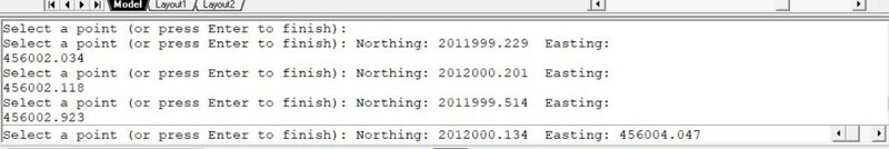

Please help me with this;
While picking points, the data/text in the command line gets wrapped even though there is more space.

@NanGlase I'm afraid you don't have much control over how the command line wraps. I suggest you just make your prompts a bit shorter:
(strcat "\nSelect a point (or Enter to finish): "
                          "North: " (rtos (cadr (last points)) 2 3)
                          "East: " (rtos (car (last points)) 2 3))
P.S. Please edit your original post and put your code in code tags. i.e. select the code and cut it to the clipboard, then use the formatting button "<>" and paste the code into the popup code window. In the lower right, select "no syntax highlighting" from the dropdown box.

revised code worked! Can you give me some links so that I can practice better code tagging? im just using notepad++? thanks a lot!

yeah, got it already. anyways, you had suggested a revised code a bit shorter and it worked for me. thanks!
