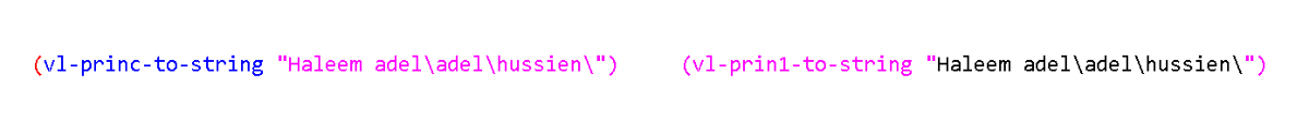

GLAVCVS Posted 13 hours ago Posted 13 hours ago 4 hours ago, Haleem said: That works fine, Thanks Steven Are you really sure it works? The '\' character in Lisp, before any punctuation mark, modifies the original character. For this reason, the '\' before the final " character prevents the string from fulfilling its function as a string delimiter. In the attached image you can see what I mean. Quote
GLAVCVS Posted 13 hours ago Posted 13 hours ago The problem is in the text string itself that is used as an argument. That is why I asked you where the source of that argument is. If it is the result of copying a text string from Windows Explorer or any other external application, I think you will have no choice but to modify it manually. But if you get it from Lisp (which I believe is not possible) please tell us how you get it. Quote
Haleem Posted 13 hours ago Author Posted 13 hours ago I used the getfiled function to get the file path, which I then used to write a script file and execute it. However, I faced an issue with how the file path was being formatted. When I used princ or write, the file path displayed only single backslashes (\), causing errors in the script because backslashes need to be escaped. To fix this, I used prin1, which correctly preserved the double backslashes (\\) in the file path, making it work as expected. Quote
