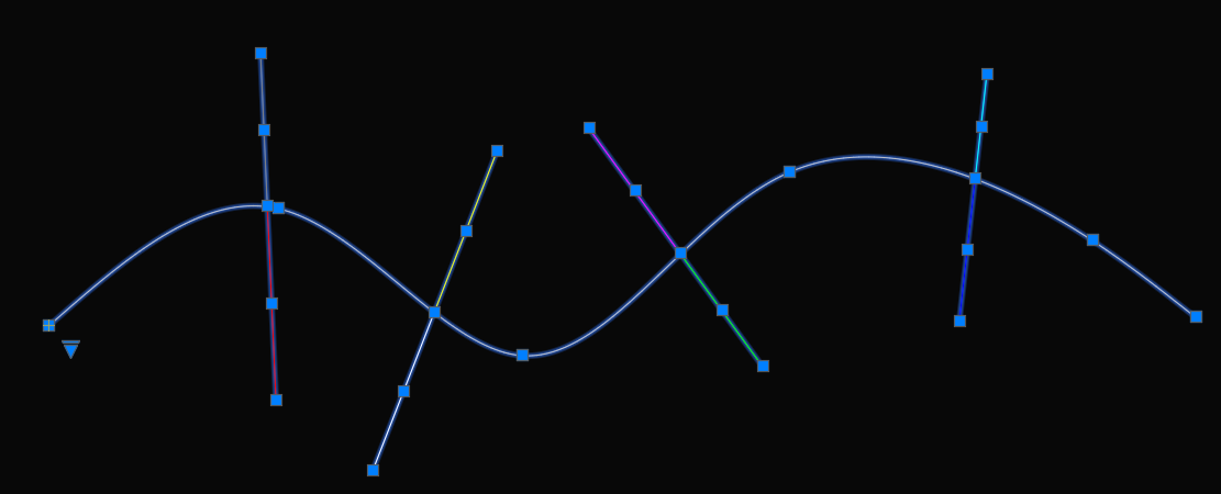

I have lots of LINES. And those lines crossing by a SPLINE.
I want to  each lines break at intersection points.
The spline should keep remain without breaking.
Give this a try ( use breakwith )... quick test here and it worked perfectly.
