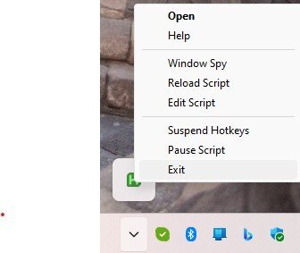

Another approach is to use the AutoHotkey program, as follows:
1. Download and install the AutoHotkey program from the address: https://www.autohotkey.com/
2. Create a text file and name it, for example, NOT_F1.AHK (the AHK extension is mandatory!). The file will contain a single line, as below:
F1::return
3. Launch the script by double-clicking on its name. The F1 key will be disabled for ALL your programs!
4. An icon will be created in the System tray, as in the attached picture.
5. If you want to reactivate the F1 key, press Exit and you will restore the functionality of the F1 key.

I'm not saying that the AutoHotkey solution is the best! It's just another approach. In AutoHotkey there is also possible to disable a key only for a specific window. I don't want to go into details. On the other hand, not all CAD programs can apply the CUI solution. For example, it doesn't work in ZWCAD.
