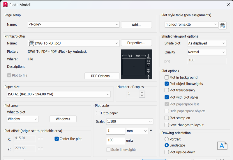

I'm an architecture student (using autocad 2025) and I don't really know how to explain this issue but its in AutoCAD and Revit when i try to plot in AutoCAD the plans gets really small yes i checked the units (working in meters), page setup and all and tried older plans which worked with it before but when i installed 2025 AutoCAD i started getting this issue i don't know is it because i tried AutoCAD architecture as well but the issue still present and when i try to import it to Revit i get the same issue where my dwg file plan gets really small i checked the measurements with dimensions tool as well and everything is fine it just gets really small in revit import and autocad plot

Did you try changing the Plot Scale, usually, if you have everything correct, 1:1 should show correctly.
Plot area is Window. Where is your window?
You really need to post a .dwg for a proper answer.
