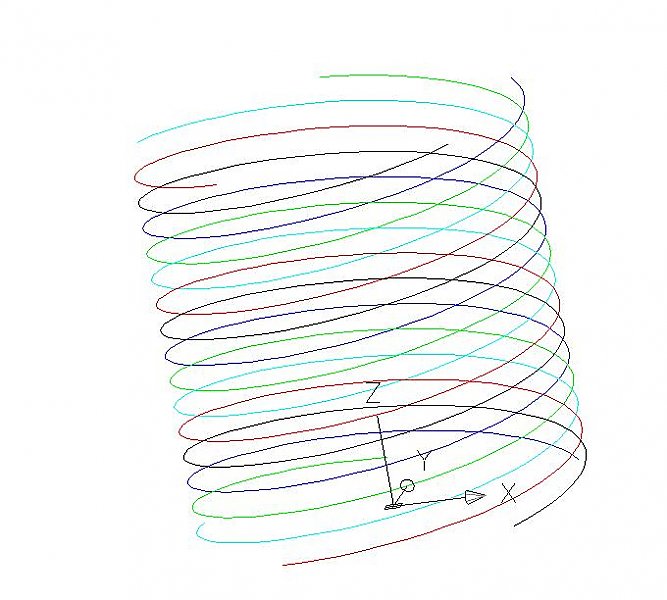

Rise Posted April 15, 2009 Posted April 15, 2009 Hi, I'm having some difficulty in figuring out how to model a multi-start thread model. It's basically a worm gear that has N starts where N will most likely be the number 5. This means that at the bottom of the worm gear, you will see the thread starting in 5 different areas. So far, the best Idea I have come up with is making 5 helix models and maybe trying to union them together some how, but I'm not sure if that's the best way (or if it would even work?). Has anyone on these forums tried this before? Or maybe have some ideas on how to make it work? edit: making 5 helixes with 72 degree angles between each start gives me the shape I want. But I still don't know how to model it! Quote
shift1313 Posted April 15, 2009 Posted April 15, 2009 i would create one helix, copy it and rotate each copy 72 degrees in your case then move them all back to the same base point. then use these paths to sweep your thread and cut it from your model but no ive never done this before Quote

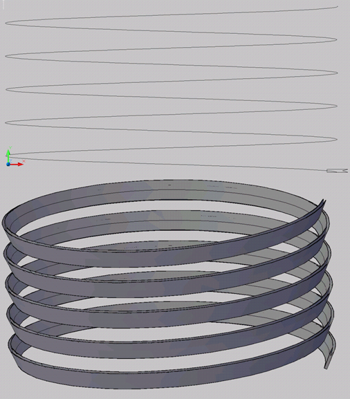

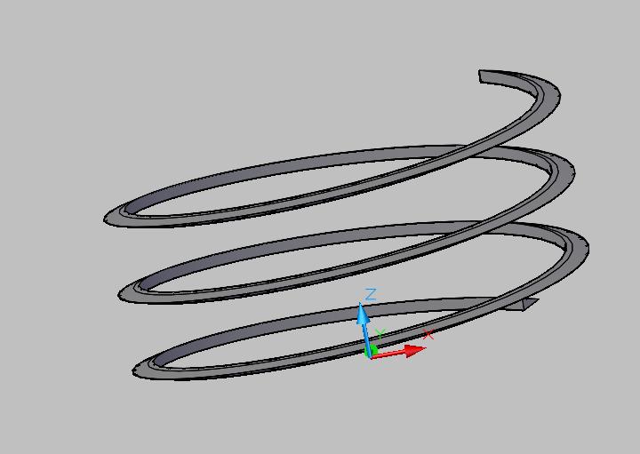

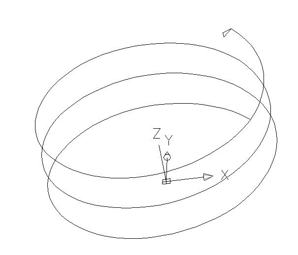

shift1313 Posted April 15, 2009 Posted April 15, 2009 just as jd said, the amount of time spent modeling this as compared to say Inventor is huge. I drew the helix set above in Acad07. i just used the helix command and entered my values following the command line(turns, starting Dia, ending Dia etc). you will then need a closed profile(the tip of your cutting tool) and sweep that along your helix. after you have one done you can create an array. Quote
Rise Posted April 15, 2009 Author Posted April 15, 2009 I can't get the profile to sweep - it turns the profile to some weird angle... Quote
JD Mather Posted April 15, 2009 Posted April 15, 2009 Make sure you turn off Align. http://home.pct.edu/~jmather/content/CAD238/AutoCAD%202007%20Tutorial%204.pdf step 7. Didn't I recommend going through all of the tutorials? By the way, that doesn't look like the correct profile for a worm gear? Quote

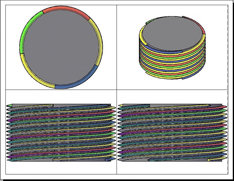

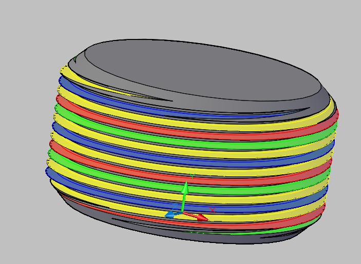

shift1313 Posted April 15, 2009 Posted April 15, 2009 there are options when sweeping a profile for twist, alignment etc. Your best bet is to align your cross section with you helix before the sweep. This way you know its perpendicular. here is one i drew real quick. i didnt use the sweep to subtract from the cylinder but if i were drawing this for real, i would do it that way like it would actually be produced. Quote

shift1313 Posted April 15, 2009 Posted April 15, 2009 dont forget about the thread starts. I would create a profile and revolve it after to chamfer them. what im saying is draw your gear longer so you can cut it down. Quote
