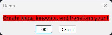

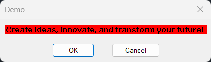

In AutoCAD, when using width = 50.5, the result is perfect. However, in BricsCAD, the text appears smaller and is not fully displayed, as shown below:
BricsCAD:

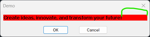

When I increase the length, the text is no longer centered and part of it sticks out. My question is: how can I center this text in this context? Also, is it possible to increase the font size to make the text larger?

To center:
Is the only method to calculate the size and add spaces?
To increase the font size:
I am already using the method suggested in the link to increase the font, but I would like to increase it a bit more.
Pretty much, DCL isn't an easy a graphical interface, it works well on a grid but variable things like centre text it struggles with. Have to calculate things.
One thing I did do once was to create an alphabet of vector images and use each vector in an image to create text, which gives the result you want... however this was a lot of work to draw them all out, and untested in BricsCAD - it should work but might not. Also allowed for image buttons - click on the text to do stuff, text and background of every (colour book) colour.
How important is it to get this text centred in AutoCAD and BricsCAD and compared to the work required to make it work is it worth the effort?
  • Agree 1
You can very much a maybe use "strlen" which is how many characters in a string, so using some fuzzy factor for a character width * strlen, make the dcl WIDTH to suit. Not tested.
Looking in the bible, Autocad R12 customization manual, there are other tiles such as text and paragraph that may be useful. Page 164 talks about using text with changing values eg "Northing X Easting Y" where the values of X & Y are supplied. "Northing 123.456 Easting 789.678" Uses text_part in dcl, in conjunction with paragraph.
Or may be use an edit box using above method.
If get time may have a go at using the other dcl options.
