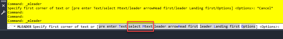

1 hour ago, rcb007 said:
After looking at the example drawing, and the way the command it used, you can just type "txt2mtxt" (a default autocad command) select the text object and then run your command, alternatively you could include an if statement that will run the command if the selected object is "TEXT" and otherwise run the code as normal.
That is a good point. I did try to do that, but the direct texts which have a field value to them, get transferred to Mtext without the field value. It becomes dumb text.

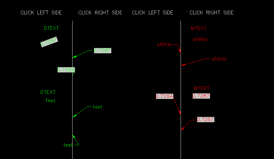

Hosneyalaa had it I think.
In your first code you might want to investigate what the output result of (vlax-get-property oobj 'ObjectName) is.... I don't think it is this string: "AcDbMText,AcDbText" (iin the " " it is seen as a single string and not a list)
Might need an (OR  ) statement in there somewhere....
Thank you guys. @hosneyalaa. I think you are so close. I like the idea you took to extract the text. Carrying over the fields to the mleaders seemed to work. Only thing, I am trying to figure out the formatting as I try to click to the left side or the right side.
