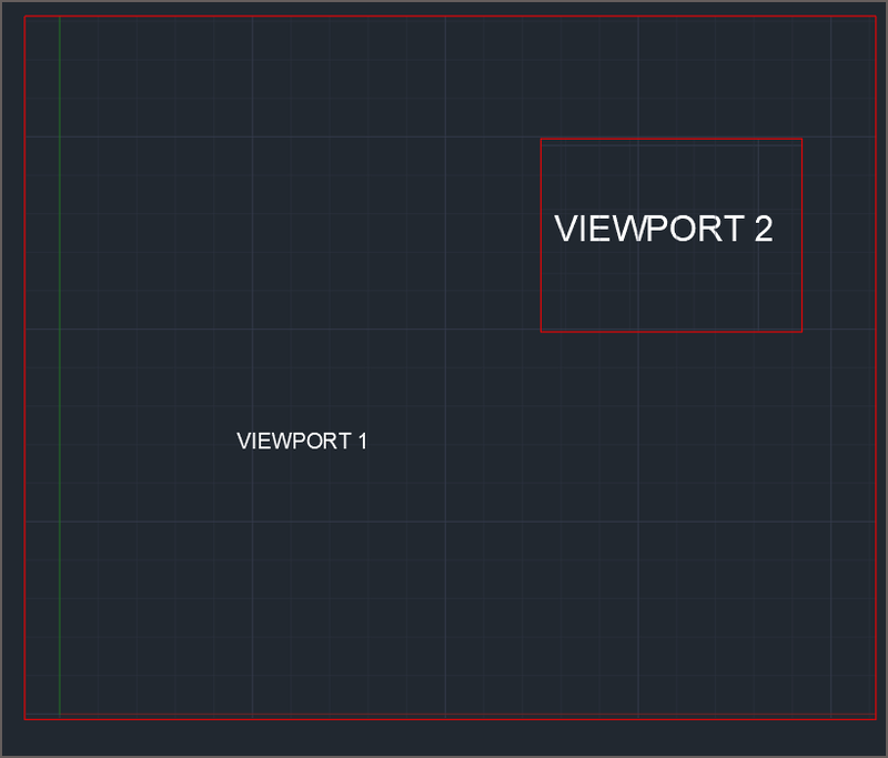

The second question is a bit more specific: in order to adapt the way we are working right now to layout space, I find nesting viewports quite useful, having one big viewport for the whole drawing then small viewports for the details, something like this:
The thing is, whenever I try entering Viewport 2 by double clicking inside it, it enters viewport 1, is there any way to correct this? I know I can double click the red line to enter to full model space view, but still editing on the viewport context can be really useful.

I prefer in most situations to place annotations in paperspace. If annotative scales are needed for some reason, check out SELECTIONANNODISPLAY and set to 0 I believe.
Often I can get in the correct ViewPort by clicking, but if the main one activates instead, use Ctrl+R to cycle through them.
Change viewports with multiple viewports in one layout

The one main thing for me is when your happy with a viewport lock it. Its easy to go inside and edit something doing a pan or zoom then you realise you have stuffed up the look of the viewport. Ok a hint if working metric have the viewports toolbar displayed, when you go into a viewport you will see the current scale displayed, a nice thing is that you can type a number in there and the view port rescales. For metric working in metres 1:100 type 10 it's that simple.
Working on a pick point in model make a layout and viewport at correct scale. Are you metric or imperial, need help with imperial.
