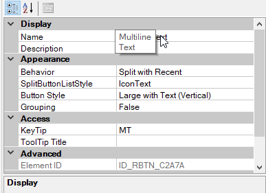

Hi, I am trying to update my ribbon palettes and make some buttons Large with Text (Vertical). I do the same settings with Autocad but the display name not warp. Then I realize that when I put my cursor on top of MultilineText (for example) pop up the text warp and not as line text. How to do that !!!!!!
Thanks
Any one knows how to make the Name Title warp like MultilineText?
Thanks
I find it !!!!!!
Note: The \n forces the label to be displayed on two lines. The \n disappears after pressing Enter or when text box loses the focus. If you don't see the changes in the Panel Preview, click Row 1 under My HYT Panel to refresh the preview.
