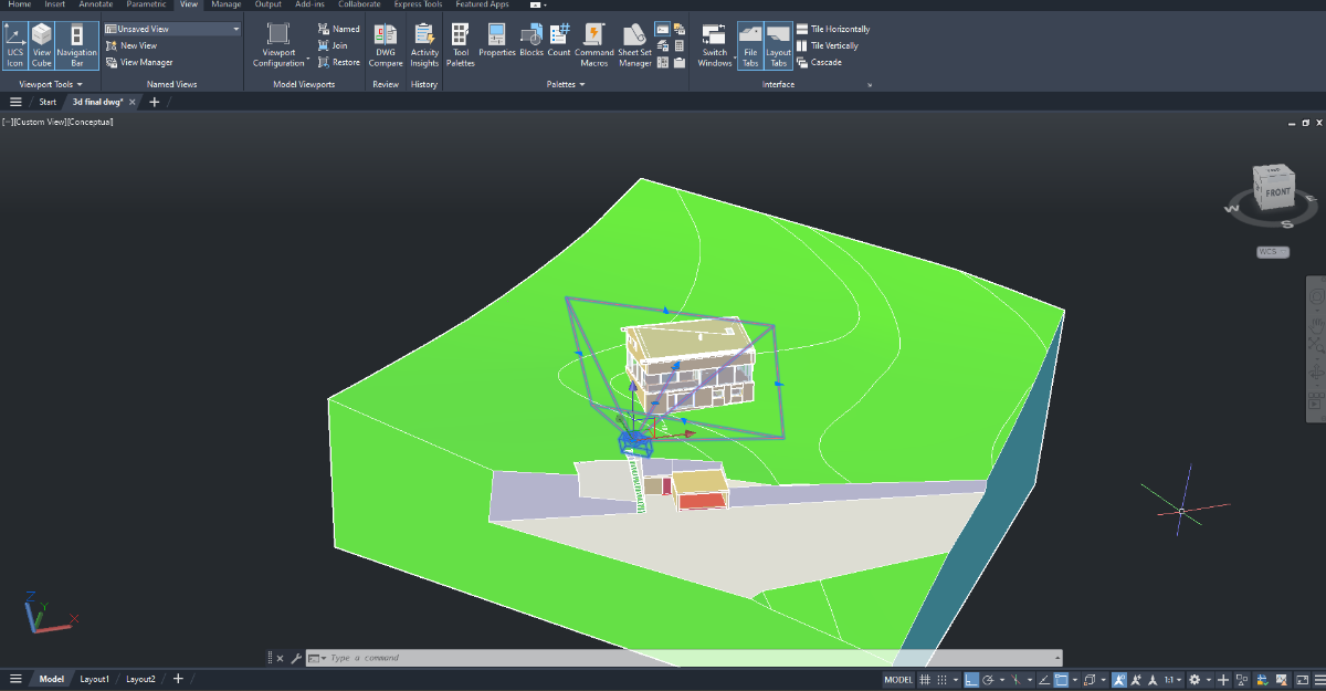

i need to make 4  perspective views for my uni project by imposing camera on specific points. I did not find any youtube tutorials and do not know how to proceed with this task. I already put the camera but how to proceed in order to create this view- making a sort of flatshot? I need it explained step by step what to click because I am very bad at AutoCAD as I am first year student and I do this for first time.

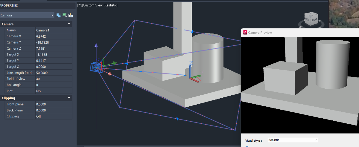

I would start as follows.
  1. Create a vertical line (pole) at the x,y location where you would like to place a camera then use  the camera command to create and place the camera.
  2. Using object snap nearest, click on the vertical line at a point where you would like to position the camera.
  3. For the target position click at a point in your model that will be the approximate center for the perspective view.
  4. Select the camera and you will see something like this.

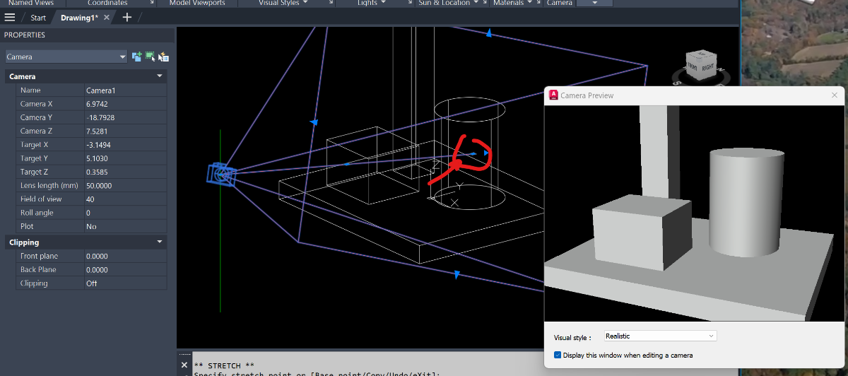

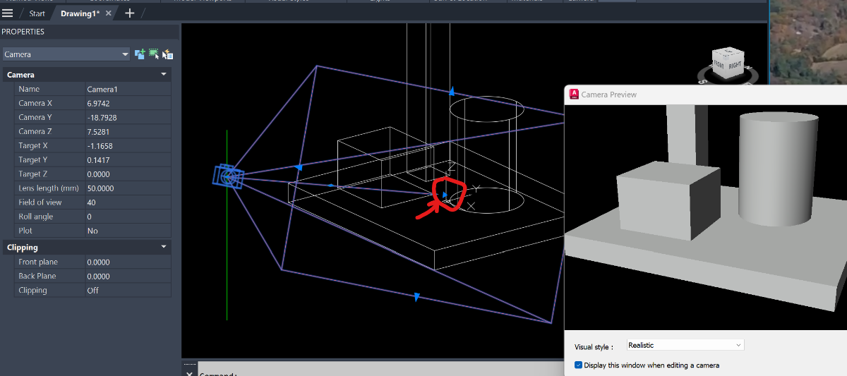

  5. Change to wireframe visualstyle and move the target point around so the the Camera Preview shows an acceptable croppig of the scene.  YOU can also adjust the view by changing the camera values (e.g., camera and target location, lens focal length) in the properties panel.
  6. Issue the render command and evaluate the results and when you like what you see click the Save icon in the render window.
