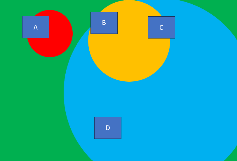

I'm asking for your help again with my plans with buildings. The idea here is that I have a layer containing buildings and other layers with hatched areas in different colors (red, orange, yellow...). Ideally, I'd like to write in an Excel file the names of the buildings in the red zone, those in the orange zone etc...

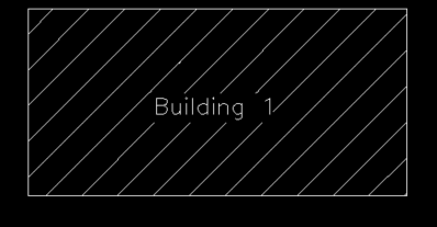

No something like this is ok. You get all the outside plines with a ssget, you run a loop of these plines and use a 2nd ssget "_CP" and look for text on your Building Layer. The "Building 1" can also be a block with an attribute of the building name.
Can help with the Excel bit as well.
You need to post a sample dwg say like image. Need a Excel sample as well so can see desired output.
Ah yes, it's practical that way. Most of the building names aren't inside the building outlines, but I'll fix that :).
Here's a diagram of what my drawings look like

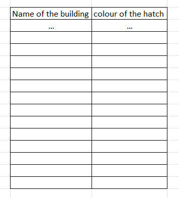

For the excel part, I'd like to have something like this:
Thanks
