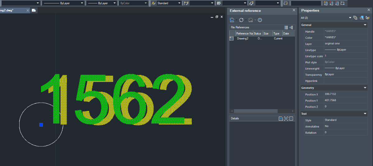

I have a problem with converting TEXT objects to MTEXT. Every time I use Lisp, the new MTEXT objects are slightly shifted from the original TEXT objects. Does anyone know why this happens and how to fix it? Sample image and DWG
White - orginal one
Yellow lisp t2m
Red lisp T1MJ

@zwonko Why not just use Express Tools TXT2MTXT command?
The width of .79 seems to be the issue.
It remains in position if width is 1 on my test with the Express Tool.
Odd, never noticed this before, even with width of 1 it is shifting slightly
Untested for now, perhaps grab the first text justification (dxf codes 70 and 73 (https://help.autodesk.com/view/OARX/2024/ENU/?guid=GUID-62E5383D-8A14-47B4-BFC4-35824CAE8363) ), justify the text to top left (see below), grab the text coordinates, txt2mtxt the first text, move to the recorded coordinates and reset to the justification recorded earlier.. then add all the other texts. Might fix it.
It is a known bug but not quite fixed yet.

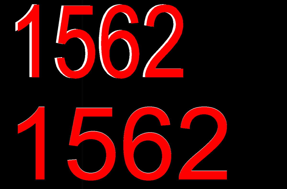

In my test no. Even insertion point is same, widht 1 there is a diverence in apperance:

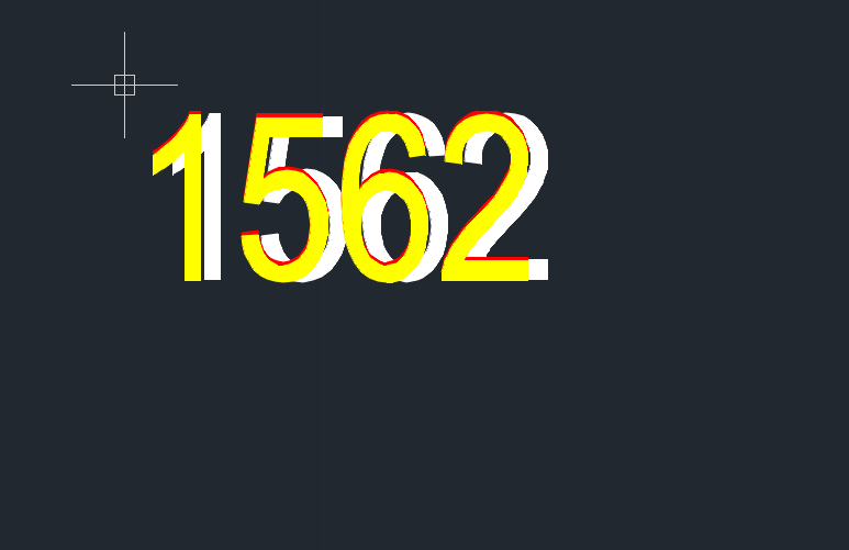

It does move very slightly in my AutoCAD if Width is 1 and then only vertically.
You might also look into line space style on the MText after Txt2Mtxt I set to exact and it lined up.

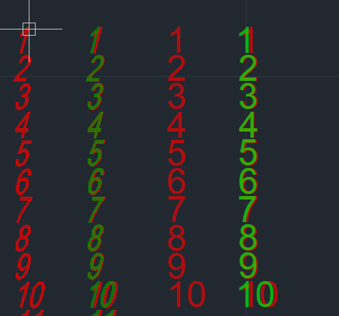

how it looks in zwcad:
From my observation the difference in move depends of what is written inside. "1" on the beggining gives bigger difference. But thought about workaround. I will try write it later.
Not sure on ZWCAD, but my last post shows a perfect match with width = 1 and line space style set exact.

Maybe somebody tell's me why it is slow (29objects in 13sec). Popably it is becouse off many commands. Maybe somebody knows how to speed up this code?
Edited by zwonko
code updated, much faster (29objects in 1.3sec)
