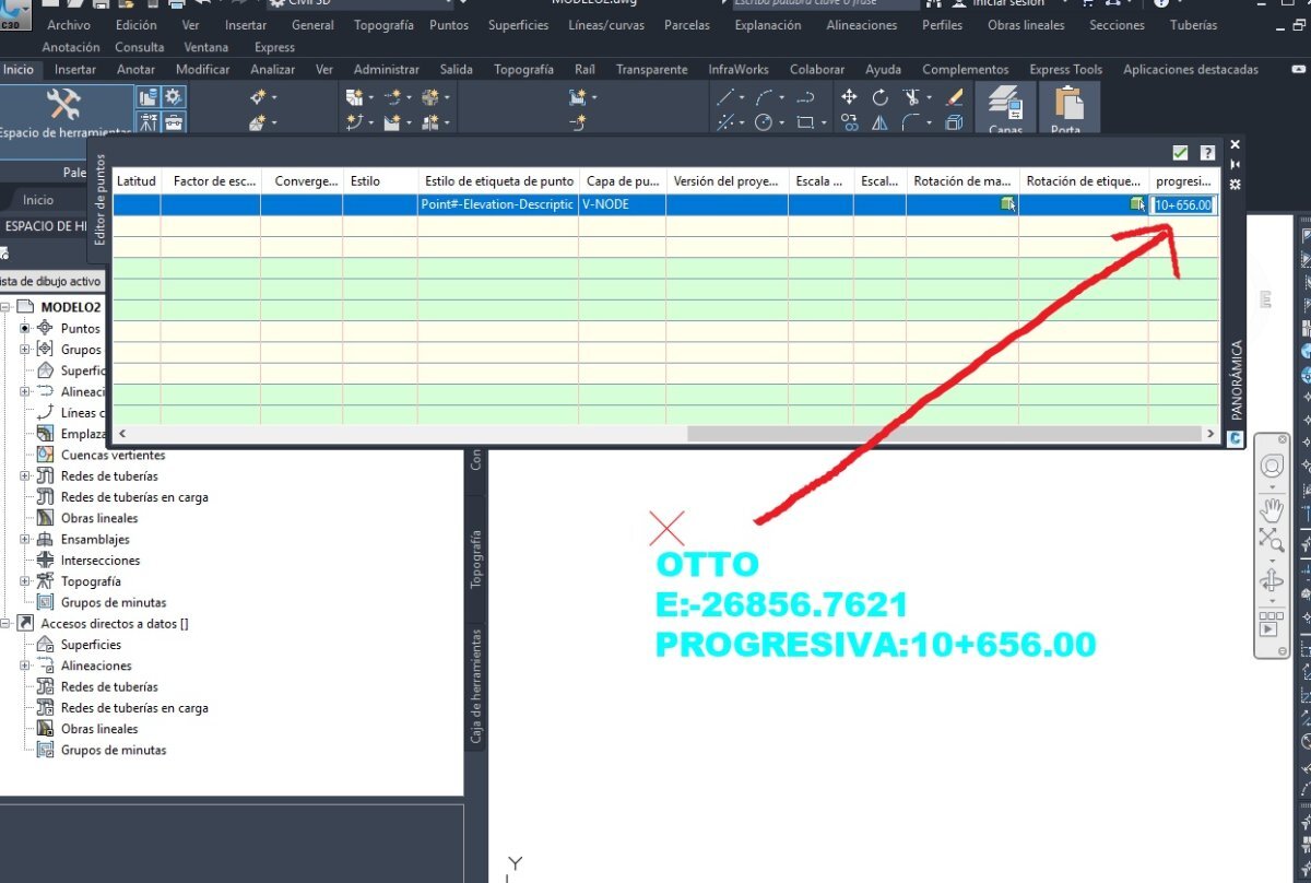

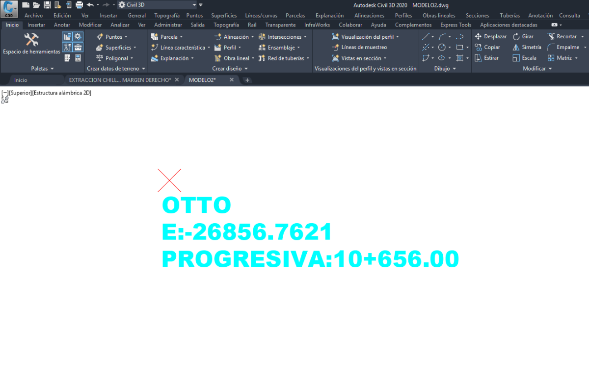

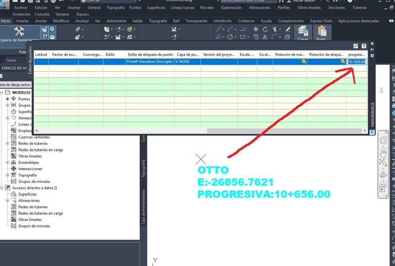

Hi @alanjt and @Grande,
I think I didn’t explain myself clearly in my previous message, so I’d like to clarify my situation:
Currently, I have predefined COGO points in Civil 3D with a custom style to which I’ve added an extra label called “progresivaa”. This label appears in the point’s presentation and has a unique value for each point, which I’ve been editing manually so far.
A few days ago, I managed to program a Lisp that retrieves this value. Now, I want to take it a step further: I’m looking for an algorithm or Lisp code that allows me to automatically edit or add these values to the “progresivaa” label for each selected COGO point.
I would greatly appreciate any guidance, code examples, or ideas you can share to help me achieve this goal.
Thank you in advance for your assistance!
Edited by cjc_cristian
Did you look at my make cogo point ? You should be able to use that to make the cogo point, with correct description. Not sure about a chainage along the alignment you may be able to do in the label style, no CIV3D at moment. Else need to get distance along alignment, you can get start chainage from an alignment using lisp.
Look at SetUserDefinedPropertyValue and GetUserDefinedPropertyValue.
Here's an example one I wrote a while back.

Yes Bigal, I have reviewed it! However, I found some issues with the code, especially in the line (setq oPoints (vlax-get-property *aeccDoc* "Points")), which gives me an error. Nevertheless, I want to thank you for the attention and for the shared codes. Finally, I was able to solve my problem by storing the progressive data in a native property of the COGO point, which allowed me to extract its value and edit it successfully.

Now, I would appreciate it if you could help me to extract, using Lisp, the X, Y coordinates of a cog point selected by the user, it would be very helpful since I still do not know many useful functions.
The cogo point has a variable called location.
(setq obj (vlax-ename->vla-object  (car (entsel "\nPick cogo point "))))
 ; vl 3d point convert to plain lisp
  (setq pt1 (vlax-safearray->list (vlax-variant-value (vlax-get-property obj "Location"))))
  (setq ht (nth 2 pt1)) ; Z val
  (setq X (nth 0 pt1))
 (setq y (nth 1 pt1))
