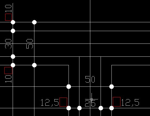

emacrisema Posted April 18, 2009 Author Posted April 18, 2009 Thanks Cad64 , I fell kind of stupid and lazy right now So this is it. How do I get rid of the area I marked (in MSPaint) with red ? Quote
eldon Posted April 18, 2009 Posted April 18, 2009 How about picking the dimension text so that the Grips show, grabbing a grip and moving the text laterally to where you want it. Quote
emacrisema Posted April 18, 2009 Author Posted April 18, 2009 I have TONS of dimensions can't just drag manually . Can't I just modify somehow the dimension style ? Quote
Cad64 Posted April 18, 2009 Posted April 18, 2009 Ummm, just an observation here, but why do you have so many lines running across your dimension lines? That is extremely difficult to read. In school they teach you to never have any lines running across your dimension lines. As for your dimension style, set the Horizontal text placement to "At Ext Line 2". I don't know of any way to adjust how far the text is from the extension line though. I think you would have to manually move it as eldon suggested. Quote
emacrisema Posted April 18, 2009 Author Posted April 18, 2009 The lines across dimensions are the objects that are measured by dimensions . Quote
Cad64 Posted April 18, 2009 Posted April 18, 2009 Understood, but I'm sure you can see how cluttered and difficult it is to read your dimensions. In general, dimensions should not be placed on top of the object they are dimensioning. They should be pulled off to the side and organized neatly so that they are easy to read and understand. Then you won't have to worry about moving the dimension text around to avoid all the lines that are getting in the way. Quote
