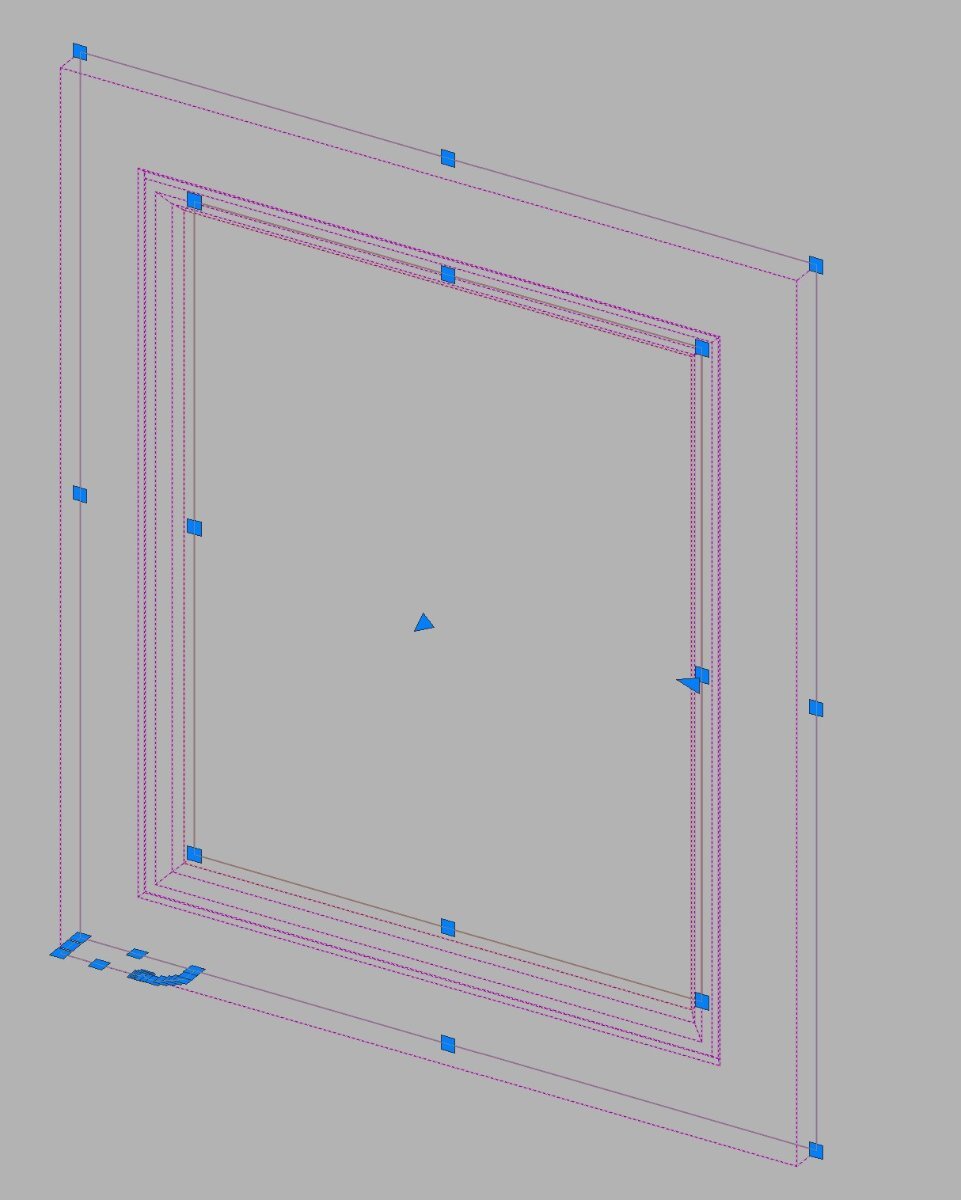

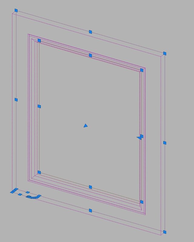

I make semi parametric cabinet doors in AutoCAD by first drawing the outside profile, drawing the outside path the profile needs to follow but, not creating a full loop, you need to stop the 2d path short of the profile. Next you use the EXTRUDE command, click the profile and choose the Path for the profile to extrude along. Once extruded, you grab the end of the extrusion grip and move it onto the start of the extrusion. This creates the rails of the door, lastly I extrude a rectangle in the centre to create the full door. This door can now be changed in size using by moving the grips of the extrusion, followed by the grips of the inside panel.
I asked the great Lee Mac my above question, he says the LISP API doesn't give much access to 3D commands so a LISP code wouldn't work.

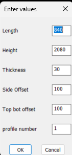

Why not do it all in one go ? That is what I am suggesting. @Dadgad is hinting can help he can use the front end if useful, was done using this. The profiles could be selected from images rather than just a description.
Multi GETVALS.lsp
