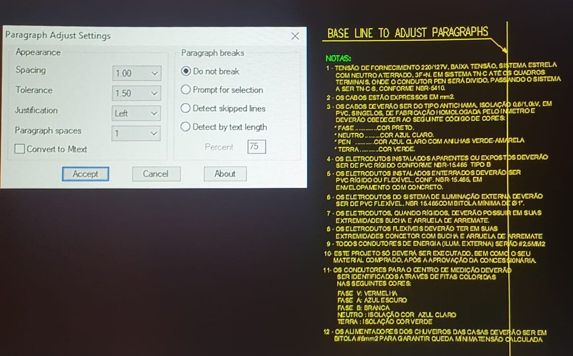

I used the "Annotate Suite" in AutoCAD 2011, which has 25 LISP programs for use with text and mtext. It was developed by PowerSolutions, which closed down, so the latest version only works in AutoCAD 2011 and below. I found some LISPs throughout the years that perform the same functions, and I used them, but there is one that I have never found and would like someone to develop. It is the Paragraph Adjustment. It is very useful for adjusting general project notes by increasing or decreasing all the paragraphs of the note to a maximum width allowed by the format of the project sheet available for each project. It does not automatically adjust all 10, 15 notes, but it helps a lot in interactive mode, adjusting paragraph by paragraph by repeating the PA command. Attached is the original explanation from the Suite's user manual. Can anyone help? I would greatly appreciate it.
PA.dwg
So how are your LISP abilities? From what I see it should be reasonably easy to create something...

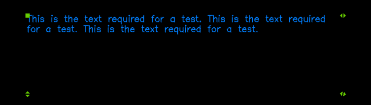

I can see a few problems, the text is very different mix, for me I would look at mtext. There is txt2mtxt as 1st step, this allows the changing of a paragraph width.
Ok may have an idea for this
This is the text required
for a test.
If you look carefully the 1st line does not have a full stop so could convert into mtext, does end of line have a full stop " If so make a new line. You would select the text and use a sort on Y for line order.
This would be a straight txt2mtxt. But then run option remove seperate lines.
This is the text required for a test.
"This is the text required for a test. This is the text required for a test. This is the text required for a test."
So may be 2 -3 different functions. Need to think about it.
A start dont run ! For the 3 lines do txt2mtxt 1st, will look into width.

Can someone help me? It's impossible for me, but I think it shouldn't be too difficult for experts.
Once you make MTEXT click it look in properties window, for Defined width it may be 0, so click on zero a line should appear on the Mtext just drag to suit width. Once you do this the next go will have all the drag arrows.
Yes could do a lisp to set width. So have a go at a lisp, just need insertion point and a new point then get distance between the points, hint using VL code.
(vlax-put obj 'width dist)
Tks Bigal, but I can't create a lisp simply because I don't know how to do it. I don't even know what vlax-put-obj means. Think about having notes with 10, 15, 20 separate paragraphs and I always need to adjust them so that they have a maximum length from the beginning of each paragraph. I think that experts can developing a lisp to do this job. The Paragraph Adjust that I use also allows you to configure the spacing between lines, the spacing between paragraphs, the tolerance of letters for more or less to define whether a word stays or continues to another line of text, the justification of the paragraph, whether right, middle, left, or any other allowed by AutoCAD, if you want it to be mtext or text, and other settings, but its only works in AutoCAD 2011. I'm just asking for the simplest thing, which is to adjust the paragraph ond by one, like in the print. No need settings. Can you do it?
This worked for me, but I haven't touched Styles and other potential parameters like current layer missmatch with original "TEXT" entity, but if you are working with only "MTEXT" entities, it should go smoothly without any problems...
