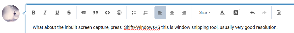

What about the inbuilt screen capture, press  Shift+Windows+S this is window snipping tool, usually very good resolution. Windows button down bottom on left on my keyboard.
