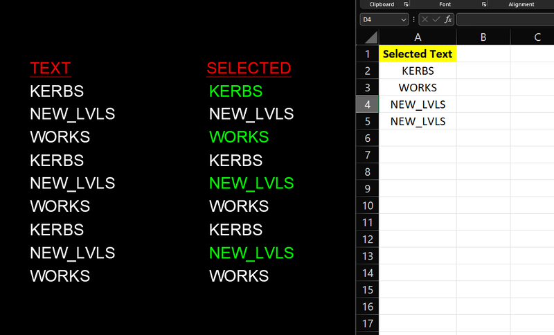

I know a lot of similar subjects there, but I need help to edit the lisp that I am using, It gives me text from AutoCAD to excel by clicking on it, even if it's Block, Attribute, Mtext or text any kind of text.
but It can't change the AutoCAD text colour after clicking, anyone  have any solution please let me know, i attach the lisp below.

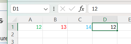

I had a play. Not sure about the numbers produced, get funny answer for RED. Cell 1 4 returns color 0 index 1 which sounds correct.

The thing I want is to change the text colour only in AutoCAD once I select it ,besides that it works perfect

You need to explain more what values need to have their color changed. Is it just all that you select  to one color ? The send to Excel is the easy bit.
