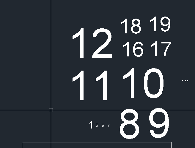

Lee Mac Posted February 22, 2010 Author Posted February 22, 2010 I have updated the code for this program in the Archive. The new version allows the user to specify whether text follows the cursor upon placement. If text is set to follow the cursor, a grRead loop must be used which doesn't permit OSnap functionality (or any other functionality for that matter), so OSnap must be cleverly imitated through the use of the Grvecs function mainly. However, if text is not set to follow the cursor, all standard AutoCAD functionality may be used. Also, the user may place text in Tables in this version. Feedback is always welcome. Lee Quote
dober Posted February 24, 2010 Posted February 24, 2010 Hello Lee For me, the text height is not accepted, the text height is always 2.5 or 25 Hallo Lee Bei mir wird die Texthöhe nicht übernommen, die Texthöhe ist immer 2,5 oder 25. Quote
Lee Mac Posted February 24, 2010 Author Posted February 24, 2010 Hi Dober, Thanks for your interest in the program, I shall look into what you have reported. Hallo Dober, Vielen Dank für Ihr Interesse an dem Programm, werde ich prüfen, was Sie gemeldet haben. Quote
mdbdesign Posted February 24, 2010 Posted February 24, 2010 Lee, when Autonumber version 5 is schedule to hit? Quote
Lee Mac Posted February 24, 2010 Author Posted February 24, 2010 Many thanks for your report Dober, I can't believe I missed that it turned out to be just a small typo on the tile key... But I have updated the code in the Archive to fix this, the new code can be found here. Again, many thanks for the feedback - it is much appreciated. Lee mdbdesign said: Lee, when Autonumber version 5 is schedule to hit? I haven't looked at that routine in a while - it probably needs a bit of a 'spring-clean'... I shall see what I can do Thanks guys, Lee Quote
