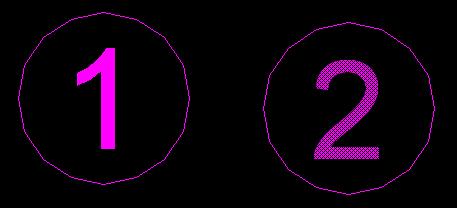

spasobn Posted July 7, 2009 Posted July 7, 2009 Lee, your NumInc is a fantastic. But, I neeed something more. I very often have to put increment number in circle. Number need to be in the center of the circle as in attach. How to do it quickly. Quote
Lee Mac Posted July 7, 2009 Author Posted July 7, 2009 Thanks for the compliments This is in fact the second request for an outlined number, - I would recommend you use TCIRCLE (from Express tools), after using my LISP Quote
spasobn Posted July 7, 2009 Posted July 7, 2009 Yes, TCircle is what I need. But, it would be so nice that you have outline options in NumInc. Expecting soon. Quote
