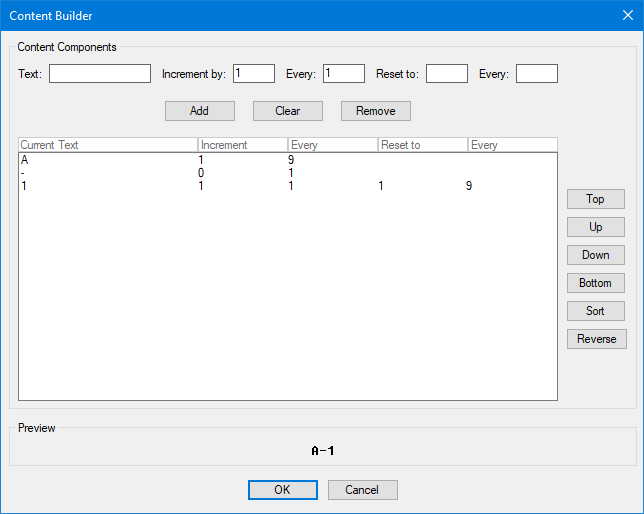

Wasn't that busy, so I thought I'd put together a little Incremental Numbering Suite for you all to sample.
I've come to realise that this kind of LISP seems to be quite a popular one in many trades, and this was my main inspiration for its creation.
As with all my programs - your comments and/or criticism is welcome, as this only helps to improve the program itself.
Main Dialog Preview:
About Dialog Preview:
Incrementing two sections of Text with a Background Mask and Rectangular Border:
Incrementing with Leading Zeros:
Text with a Slot Border:
Placing text in a Table Cell:
Incrementing Text with Leading Zeros and Hexagonal Border:
Incrementing alpha text, demonstrating rotation of Triangular Border:
Curve-Aligned Mode:
Array Example 1
Demonstrating the difference between Spacing Vector and Endpoint specification, with Object Rotation set to 'Aligned'.
Array Example 2
Demonstrating Perpendicular rotation and a fixed zero rotation.

Now that's sweet, Lee.
I made that change you made for me in a previous version to allow a leading zero in the number, and the rotation ability you put in the program really adds to the utility of it.
But then a small thought came into my head:
What if we need the prefix and the number to be static, and the suffix to increment? Only the prefix and suffix accept alpha input, but neither of these will increment.
Steve
Thanks for your suggestions Steve :)
I suppose I could include options for an incrementing Prefix and/or Suffix, but this would add extra prompts for the user. I shall have a think about this one :thumbsup:
Yep. Too many user prompts would make it a real endurance test, and might possibly turn many potential users away from it.
It's very good as is. I was just tossing out some thoughts.
Steve

This is a preliminary - I am thinking DCL may be a good call - but not sure...
Let me know of your thoughts on this:
Lee,
You should know by now.
DCL is always a good call.
The whole program in your face without anticipation of prompts.
Now thats more like it.
Outstanding work Lee.
