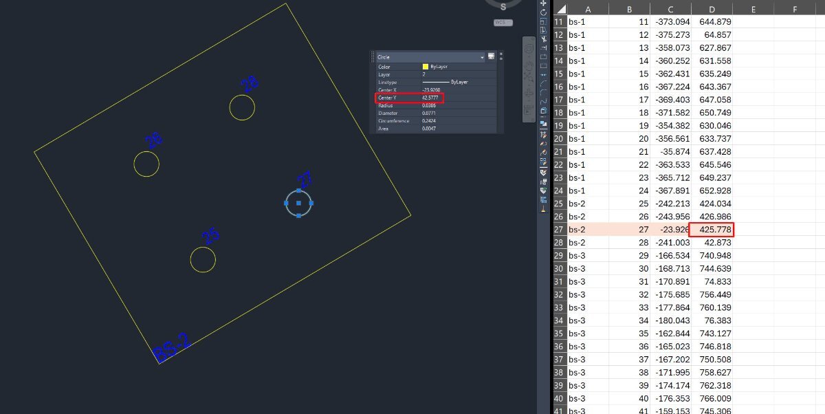

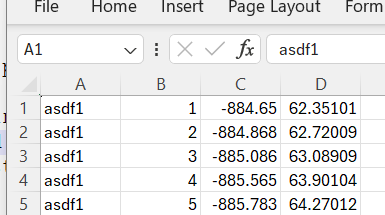

thanks bro. It worked for the numbers in the coordinates. However the numbers are not correct for the decimal point position.
I have checked the code, reposted above please copy the code and save again.
CAD
Center point:  X=   -884.6503  Y=   62.3510  Z=   0.0000
Center point:  X=   -885.7833  Y=   64.2701  Z=   0.0000
Latest version

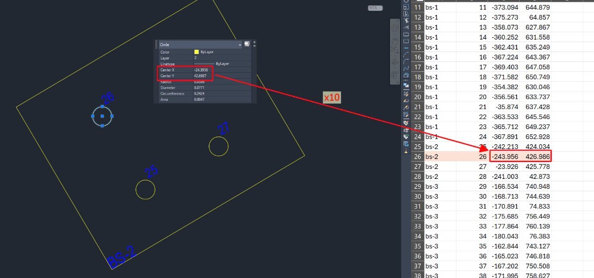

CAN YOU SEND ME THE CAD FILE AND THE EXCEL FILE AFTER RUNNING THE LISP. BECAUSE I STILL HAVE AN ERROR RELATED TO THE DECIMAL POINT WHEN I RUN THE FILE.
AND MY FILE RUN LISP
anchor bolt plan.dwg HOLE2.xlsx
3 hours ago, BIGAL said:
I don't understand this is what I got. It appears to be correct. It matches the co-ordinates you have.
anchor bolt plan (1).dwg 2.46 MB · 0 downloads Anchor bolts copy.xlsx 43.19 kB · 0 downloads

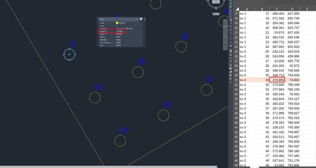

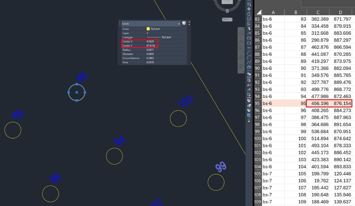

Thanks brother. I found the error: The error is because the Windows operating system installed on the computer is using a comma ( , ) as a decimal point, while CAD uses a dot ( . ). Therefore, when converting coordinates between the current UCS coordinate system and 0,0, an error occurred.
Do you have a way to fix this error, because by default I have to use a comma ( , ) as a decimal point.
There is one problem that when used multiple times, the circle order number does not reset to 1. I want to be able to set the starting order number of the rectangle and circle by entering from the keyboard.
